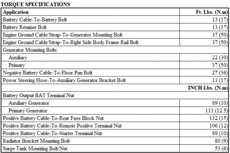

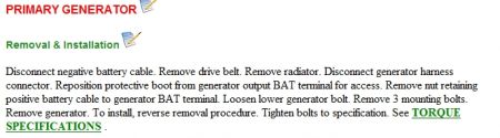

I am looking for help in removal of the alternator. I am not sure on the steps needed or of any special tricks that will help.

hello and thanks for donating below are the proper replacement steps for your vehicle's alternator..
https://images.2carpros.com/forum/automotive_pictures/261618_Noname_1948.jpg
https://images.2carpros.com/forum/automotive_pictures/261618_Noname2_626.jpg
