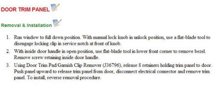

The driver window will not come up. I can hear the motor turning but the window does not move. How do I remove the driver door panel to see what has gone wrong?
