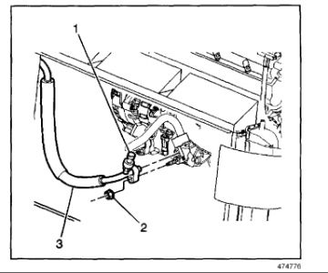

Where is the high pressure switch on the air conditioning located

Raise and support the vehicle. Refer to Lifting and Jacking the Vehicle. Remove the front air deflector. Disconnect the electrical connector from the A/C refrigerant pressure sensor (1). Remove the A/C refrigerant pressure sensor.
