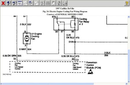

If the block and pressure test passes check the following: ,Pressure test the Rad. cap,Clogged radiator,air lock in the cooling system ,Fan clutch,Radiator electrical fan,collaspe hoses,water pump
Are the cooling fans coming on when needed/radiator not clogged-up-could be the high/low speed control of the computer see below
