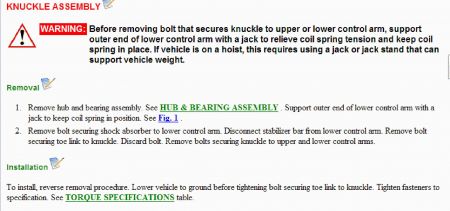

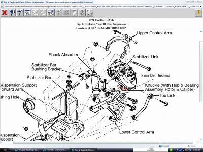

Ok this car has BAD sounds from the rear almost impossible to drive in a
straight line a local mechanic said it needed at least "knuckle" bushings
on both sides however shop would have to replace many other parts
because of policy for $1200.00 however they claim "knuckle" bushings
can't be found even in a junk yard allthough their 'quite inexpensive' .
As a third party (after many months) I was asked to find these "knuckle" bushings at any cost could someone give me a
proper part name ?? I could not see part myself when they stopped by
today. The lady owner of this car really needs to have this fixed Asap!

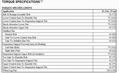

Here's an exploded view....And instructions
https://images.2carpros.com/forum/automotive_pictures/62217_Exploded_1.jpg
https://images.2carpros.com/forum/automotive_pictures/62217_Instructions_3.jpg
https://images.2carpros.com/forum/automotive_pictures/62217_Torque_Specs_1.jpg

[quote:cb52fcdc3c="drinkindex"]THATS GREAT THANKS ALOT
I UNDERSTAND WHATS THERE NOW ![/quote:cb52fcdc3c]
you have to replace the whole knuckle to get the bushings, they are expensive
