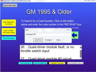

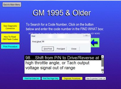

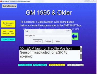

I have a 95 Cadillac Deville 125K V8. The code on it says P055 Current. Closed Throttle angle out of range.... not sure what that means or how to get it fixed.
Also, the heat barely works. I can turn it on and it blows cold air for 20 to 30 minutes then it gets warm. Sometimes I can hear the compartment move behind the dashboard but not all the time.
Please help.
PS... I cleared all the codes and P055 came back.
....previous codes were p026, p098, I039, A037 T083 all History
Nov 20, 2007 at 8:35 AM
MERLIN2021
  • 17,250 POSTS
The codes seem to point to the TPS throttle position sensor, try repacing or adjusting it. Try warming the Vehicle, then carefully feel the heater hoses, are they both hot? If one is cooler than the other, You need to flush the core, or a replacement job on the heater core. Also if the system has a heat control valve on the heater hose, make sure it is working!
https://images.2carpros.com/forum/automotive_pictures/62217_26_1.jpg
https://images.2carpros.com/forum/automotive_pictures/62217_55_1.jpg
https://images.2carpros.com/forum/automotive_pictures/62217_98_1.jpg
AS for the T code, and A code, Can't look em up!
