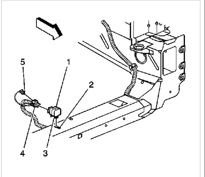

where is the location of the air bag sensors. the air bag light is on on the dashboard....they said I needed a front sensor. can't locate it...
Sep 20, 2010 at 6:23 PM
  • CAR REPAIR CONTRIBUTOR
  • 54,193 POSTS

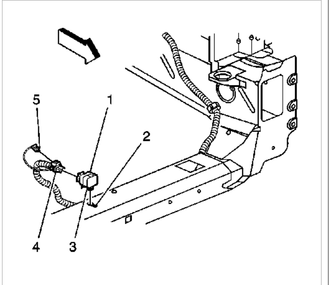

The front airbag sensor is located in the center on front side of radiator assembly. Only reason it could be bad is airbags were deployed

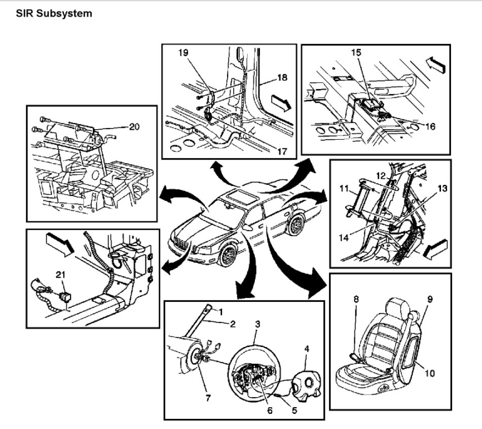

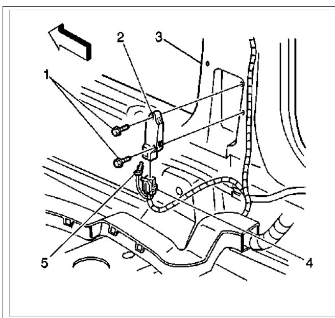

Check out the diagrams of all air bag sensor locations just in case you need it (Below)
