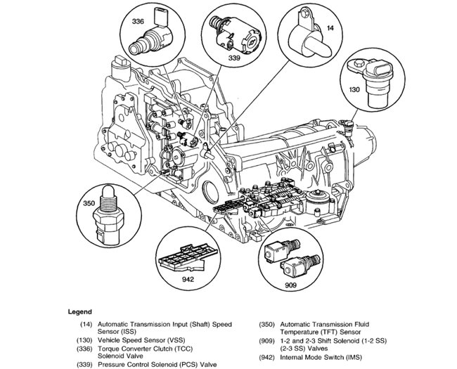

I've already done so at several sites and do not accept that a 5 year old cadillac with less than 100,000 miles needs a $4000 rebuild. I understand the code is a circuit problem with the torque convertor lockup stuck in the off position. What needs to be done to correct this problem. There are currently no other codes but I did have a p0741 and replaced the egr valve and pump recently. About 30 miles later the check light came on and this is the code I extracted.

This is common when the torque converter control solenoid goes out here is the location so you can replace it after in which you should clear the codes. Check out the diagrams (Below). Please let us know what happens.

Thanks for the information I got a new solenoid and installed it which was not the easiest but after my buddy helped me I got the job done it fixed it which paying for a new transmission this site is wonderful.
