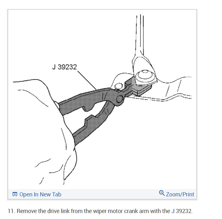

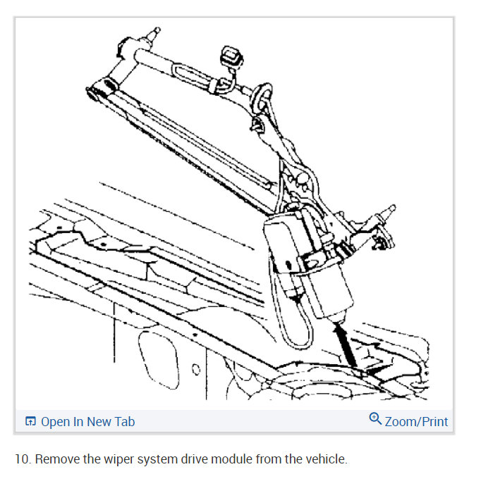

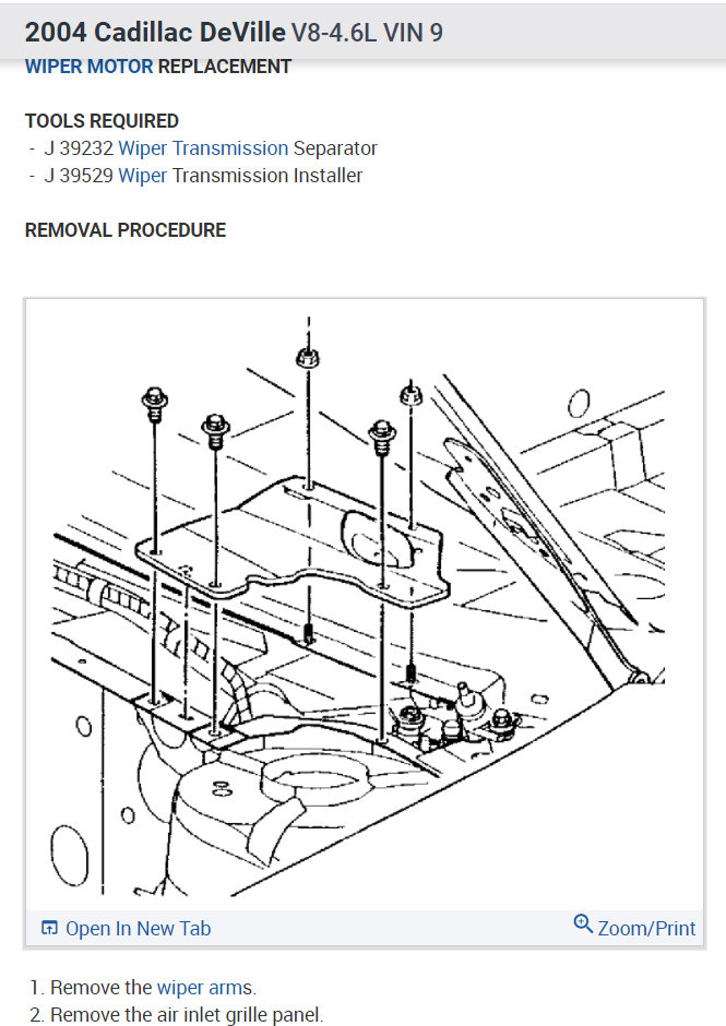

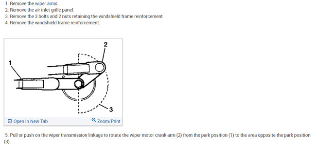

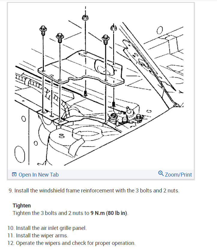

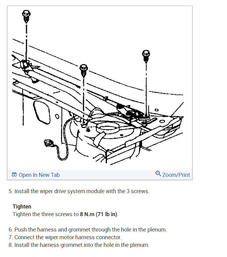

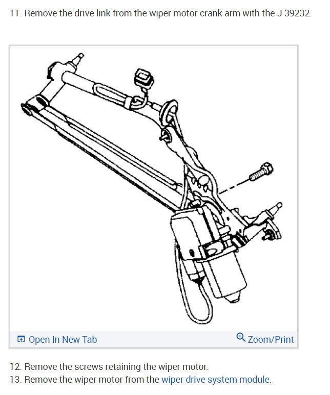

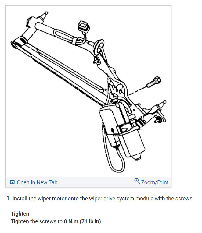

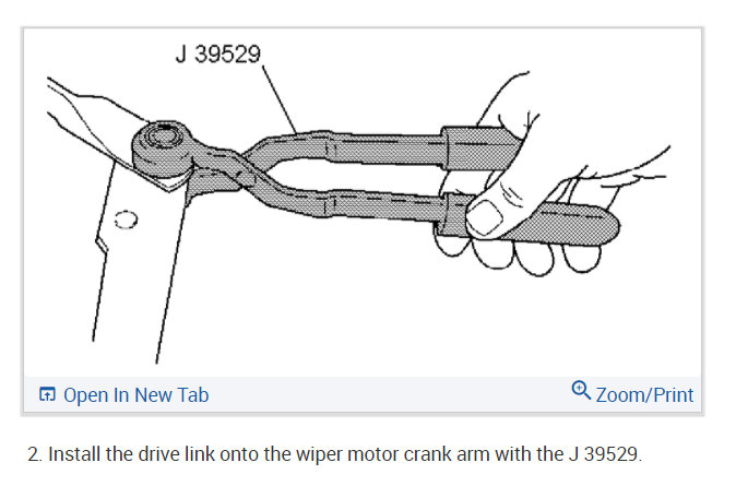

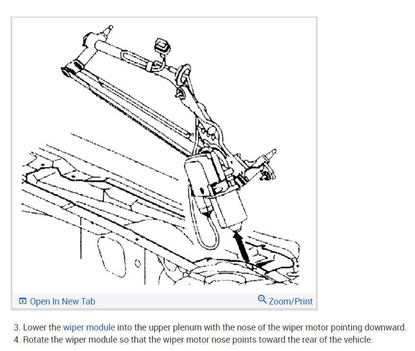

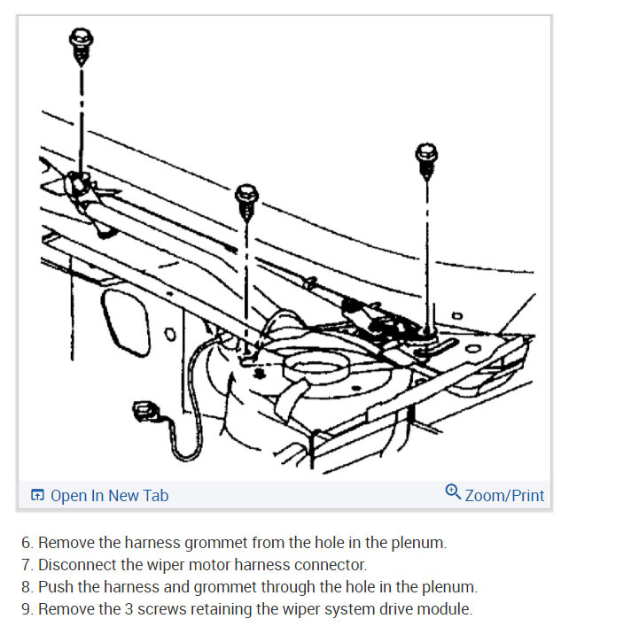

It is common for the wiper module to go out on these cars here is its location so you can change it out. Check out the diagrams (Below). Please let us know what happens.

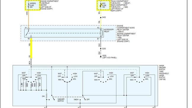

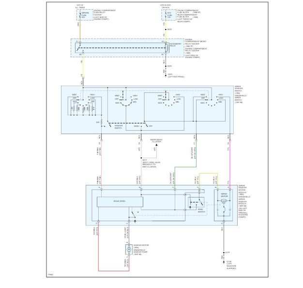

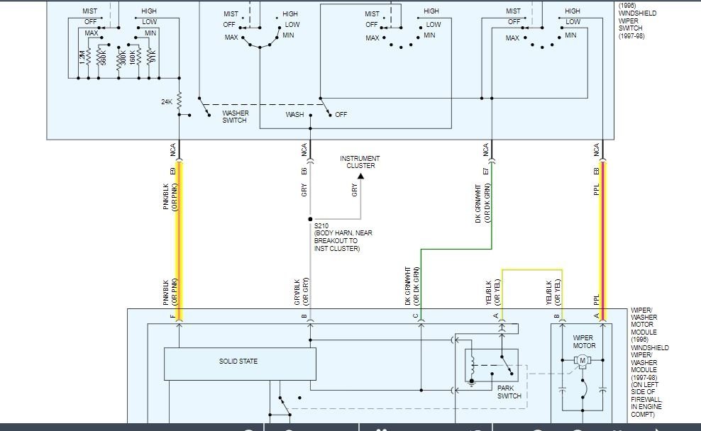

Good morning,
Check the two wires I highlighted in the attached diagram.
The purple wire should have voltage with the wiper in high-speed mode. The other highlighted wire should have voltage at the lower speeds.

Tried the two wires no power from either wire. Tried connector that's on side of wiper motor, no power.
Nov 12, 2020 at 3:17 AM (Merged)
PAULA SOTO
Hello Roy. I did what you asked testing both wires plus a plug that's on the far right side of wiper motor. No power from them.
Okay, check the yellow wire at the wiper switch. There needs to be power from the accessory relay.
Also, check both fuses listed for power on both sides with the key on.
