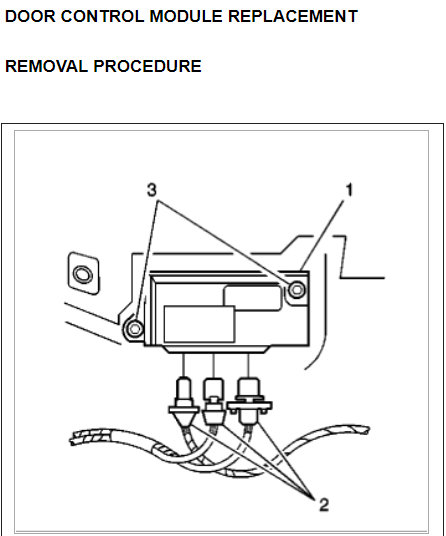

I was out doing errands, lowered my drivers window, got out, got back in, tried to put my window back up and none of the control buttons will work on my door. Auto lock, heated seats, windows, etc., nothing will work all of the sudden. The passenger side is fine, windows go up and down. The problem is just on the drivers door. Is this a fuse, loose wire or what, or am I stuck going to a dealer?

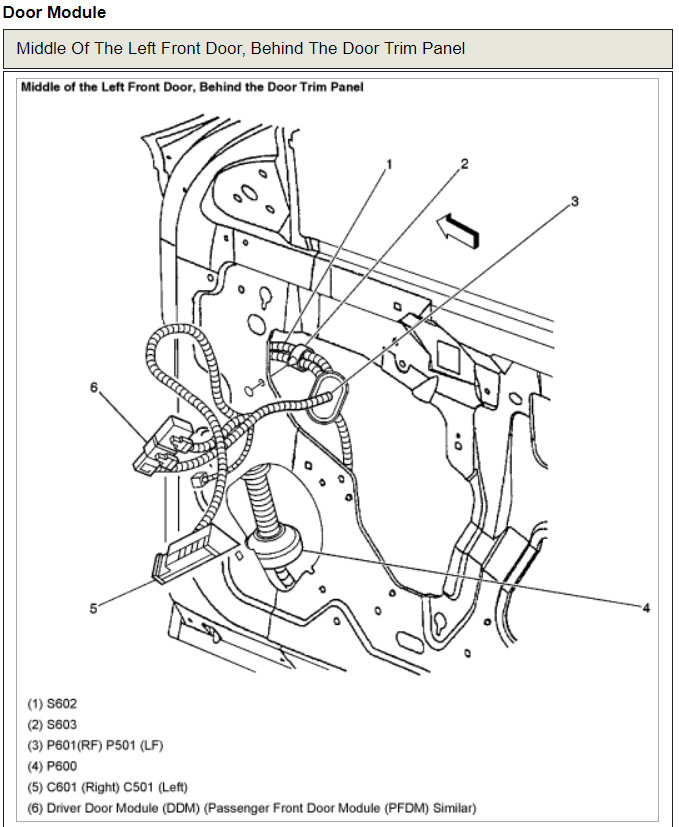

It sounds like the drivers door module is out which is common. What I would try first, is removing the Drivers door module fuse in the rear fuse block(under rear seat cushion/drivers side), I believe it is labeled DRV/MDL and 10 amp. Keep it out for a couple minutes, reinstall and check operation.
If all of that seems okay here is the location of the driver door module so you can replace it.
Cheers

I had this problem it was the DDM the dealer charged me $430.00 to fix it.
