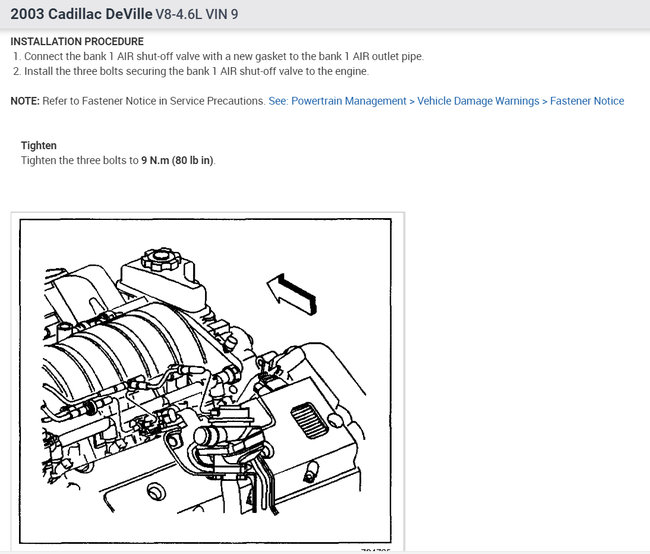

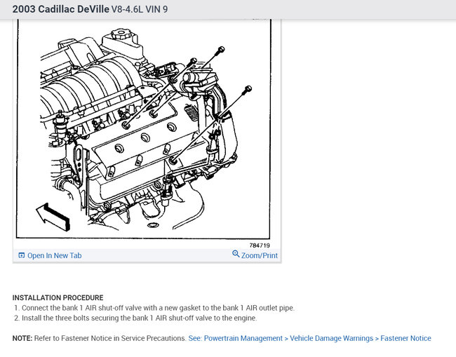

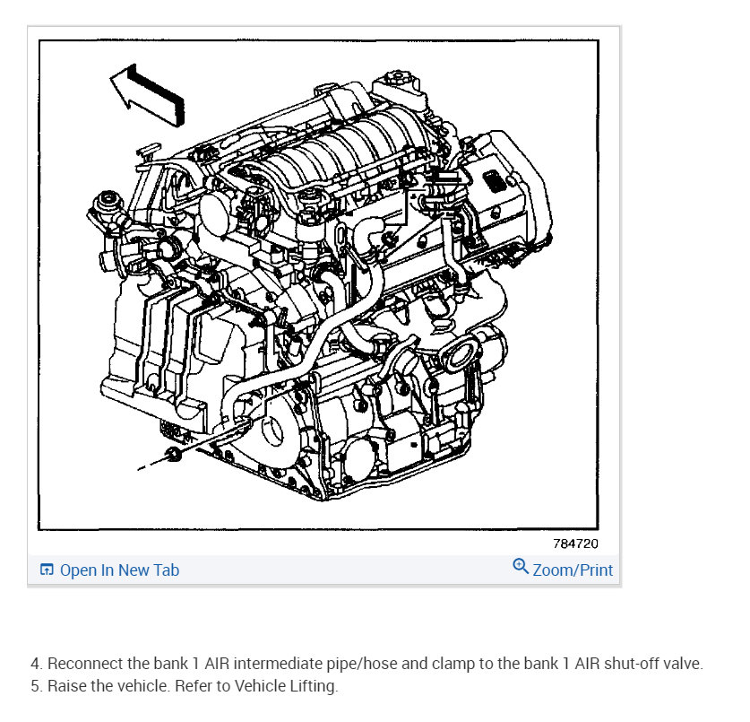

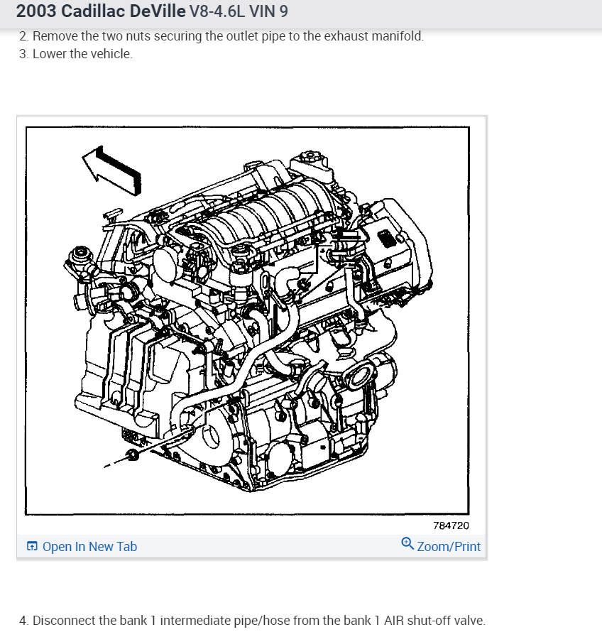

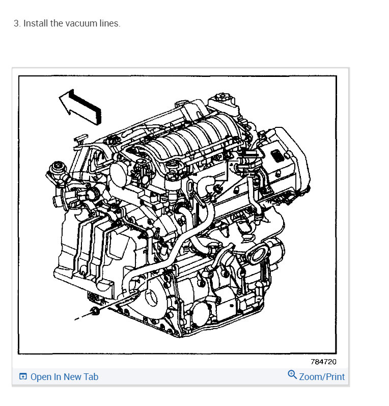

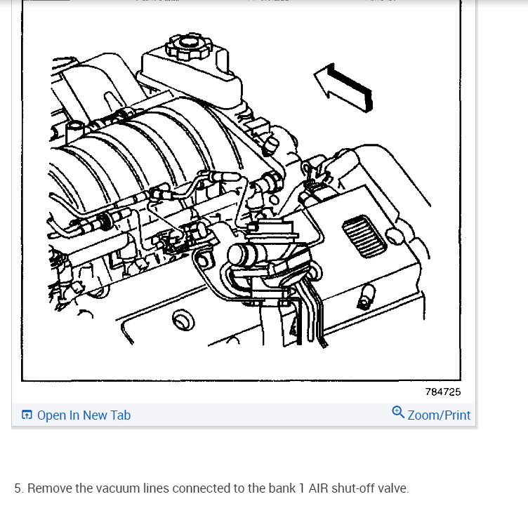

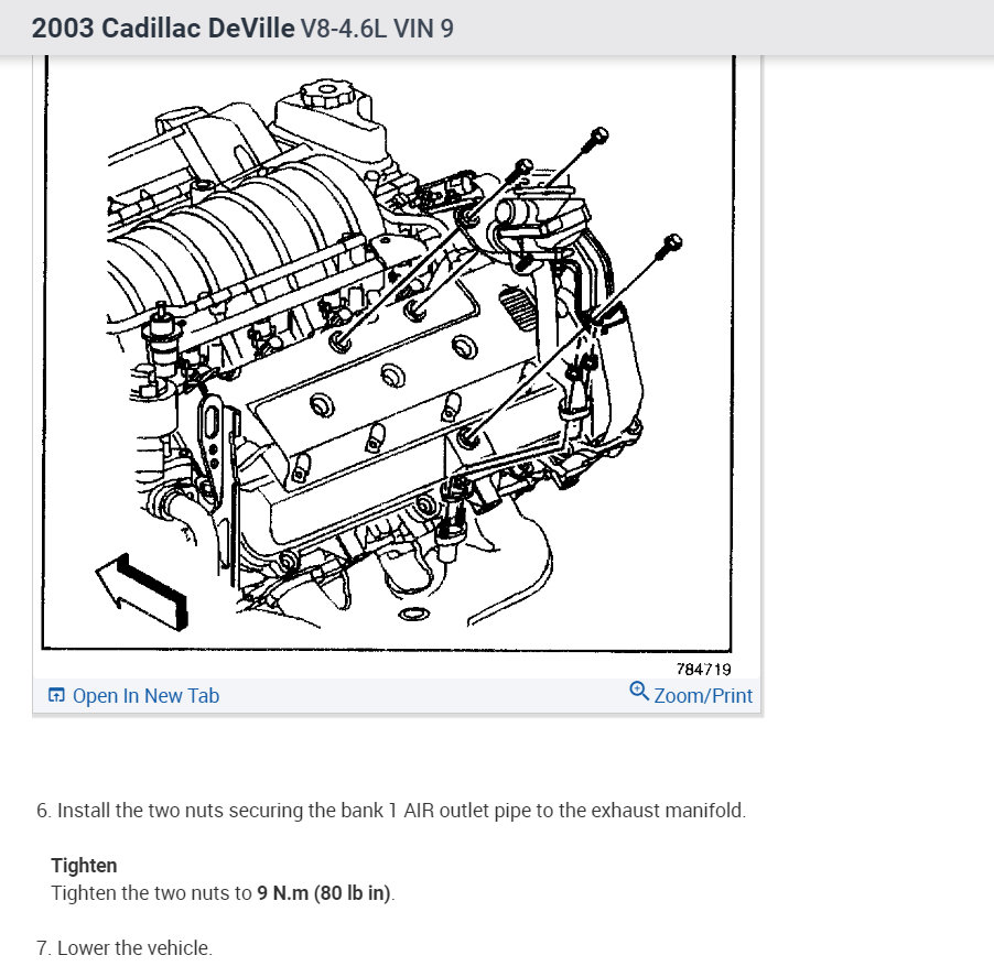

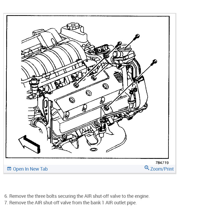

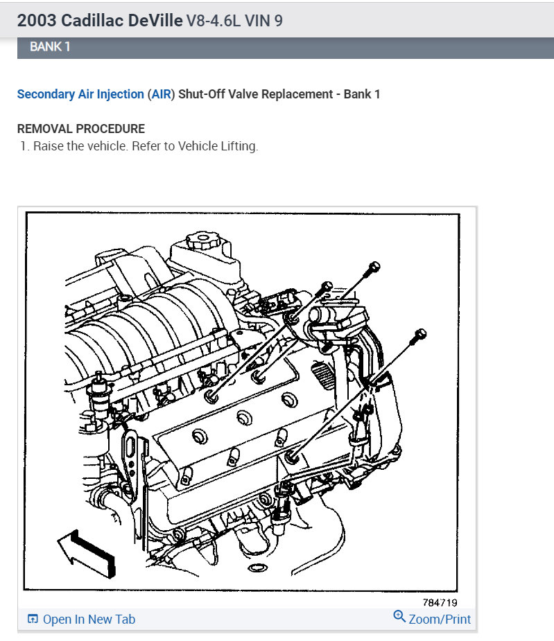

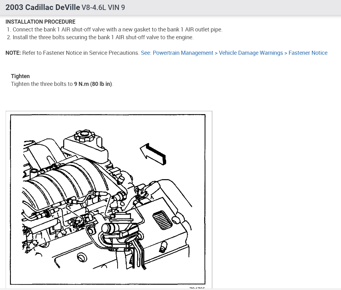

Yep, this happens when the combination valve goes out, there are two of them so I would replace both unless you see an obvious problem. here are the instructions in the diagrams below on the location and how to change them out. For the limp mode I would service the throttle actuator.
Here is a guide:
Aug 5, 2022 at 9:41 AM
