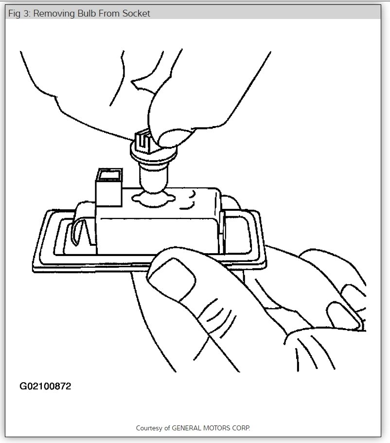

Why didn't the dealer change the bulb? Could there be a problem that he doesn't want me to know about? I already bought the car, and don't know how to find out why the light isn't working. Appreciate your assistance. About the light or bulb not working, is there a sensor in my 2003 cadillac for that? Since my car has a little window on the area where the speed, etc, shows...that tells me even if my tires are low on air, wouldn't it show if there was a problem with the electrical where the license plate bulb goes?
Aug 3, 2010 at 4:05 PM
  • 55,604 POSTS
Hi Kajern,

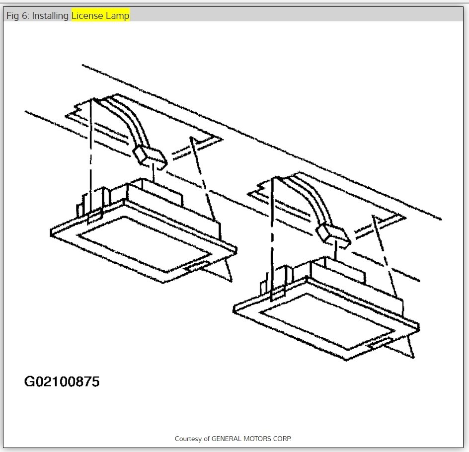

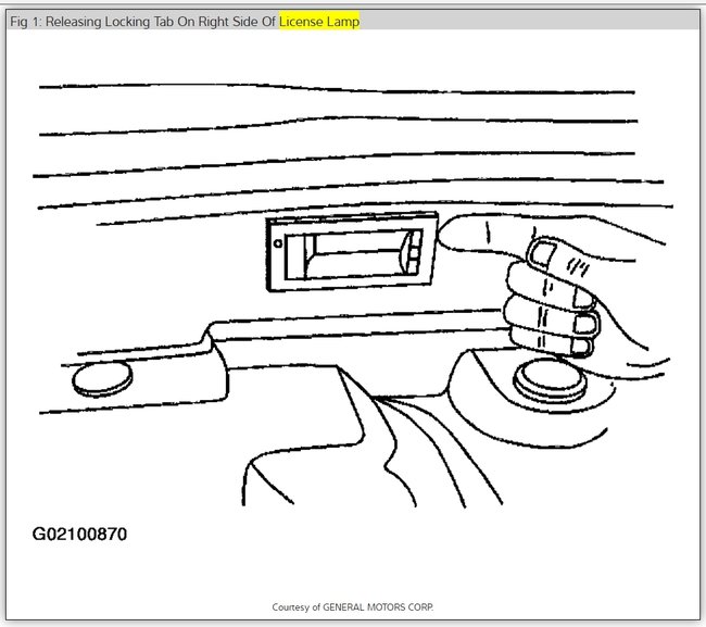

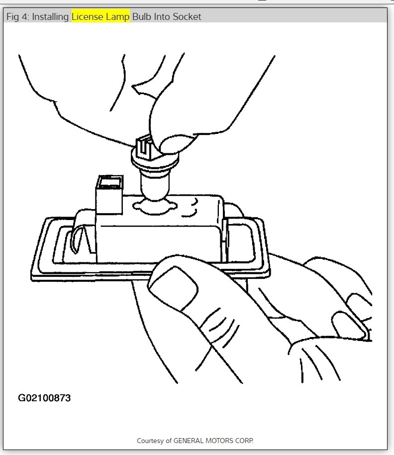

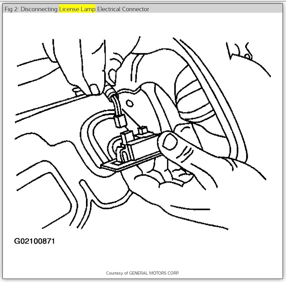

I wouldn't worry the car cannot tell if this light it out and the dealer probably overlooked it. This bulb is easy to change and will only take a few minutes. Check out the diagrams (Below). Please let us know if you need anything else to get the problem fixed.
