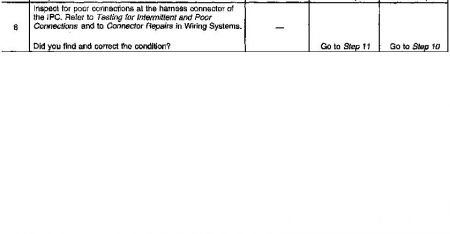

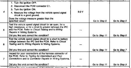

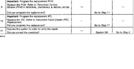

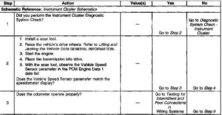

My speedometer reads zero and odometer is not advancing when I drive. At the same time my turn signals stopped functioning and compass in mirror unlit
Feb 3, 2009 at 3:27 AM
ZACKMAN
  • 4,202 POSTS
Before we rule out the vehicle speed sensor, you need to check the gauge cluster. But you have to have a scan tool to accomplish the diagnostic.
