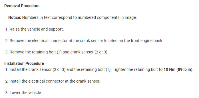

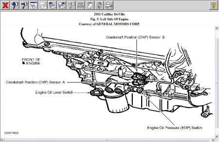

Hello -- I have provided the info your requested. REMOVAL PROCEDURE CAUTION: Refer to Vehicle Lifting Caution In Service Precautions. Raise and support the vehicle. Remove the crankshaft sensor electrical connector. Remove the crankshaft retaining bolt. Remove the crankshaft sensor. INSTALLATION PROCEDURE IMPORTANT: Inspect the crankshaft sensor O-ring for wear or damage. If a problem is found, replace the O-ring. Lubricate the crankshaft sensor O-ring with clean engine oil. NOTE: Refer to Fastener Notice in Service Precautions. IMPORTANT: Be sure to fully seat the CKP sensor into the engine block. Failure to fully seat the CKP sensor may cause a CKP sensor DTC to set. Install the crankshaft sensor and the retaining bolt. Tighten Tighten the retaining bolt between 8-11 N.m (70-100 lb in) . Install the crankshaft sensor electrical connector. CAUTION: Refer to Vehicle Lifting Caution in Service Precautions. Lower the vehicle. Operate the engine and inspect crankshaft sensor for engine oil leaks. Perform the CKP System Variation Learn Procedure. See: Testing and Inspection\Programming and Relearning
https://images.2carpros.com/forum/automotive_pictures/248015_84930635_1.jpg
Crankshaft Position (CKP) Sensor A Center front of the engine, near the base of the engine oil level switch Crankshaft Position (CKP) Sensor B Center front of the engine, near the base of the engine oil level switch

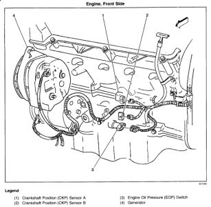

I have a 2003 Deville. Both sensors (upper and lower) are above and to the front of the oil filter. They are located behind the front engine support. I replaced mine today and thank God I have small hands. It took about 2 hours to remove them. You also have to remove the plastic pan under the front of the car. Installing new sensors ($40 each) went much quicker and no more stalling after driving the car about 1/2 hour. Last night I took the family to a restaurant across town and it stalled twice on the way there. I read on another post that Cadillac dealers charge $300 to replace them. Also, you do not have to drain the oil. The connectors were a pain, until I figured out how to remove them. Be very careful not to break them.

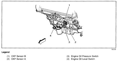

where is crankshaft position sensor located
Dec 30, 2020 at 11:17 AM (Merged)
  • 75,992 POSTS
Crankshaft Position Sensor Check out the diagrams (Below). Please let us know if you need anything else to get the problem fixed. Locations View

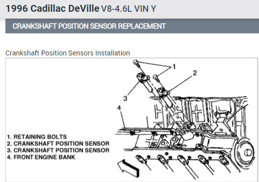

MBANKH
Computer problem
1996 Cadillac Deville V8 Front Wheel Drive Automatic
Hello. I have ran into a very strange problem that I have never seen before. I have a 96 deville I am working on that is a no spark situation with no codes present and no cranking rpm on scantool. If I unplug either crankshaft sensor the car will have a long crank but will start and run. Both crank sensors are 1140 ohms. Wiring to them from module is good and not shorted. Cam sensor is also in spects. I have looked in the crank sensor holes with a mirror and reluctor looks to be ok. The module has been changed with a known good one. All six wires from pcm to module also are good No shorts to ground or voltage. Pcm is also substitured with a known good one I have the most recent update flashed to it. I did ac voltage checks at the module plug with car idling on each open sensor. Crankshaft sensor a reads 5.1 volts when car is running and sensor b around 7 using a fluke 87 meter. I had two more cranks sensors on hand and tried them. same results. seems like a crank sensor sync problem of some kind. I have disconnect cam sensor with both cranksensors plugged in and no cranking rpm or spark. Has anyone ran into this? seems very odd. almost like the reluctor is a problem but I don't see how when it will start with either crank sensor just not both. Hope someone can give me a direction.

Thats a good one, haven't seen anything like it to this date. If you can, pull the cam sensor and see if the pin came out of the sprocket. It seems that it would still start, it just may be extended crank due to loss of #1 sync pulse. I had that happen in the past, can't remember the vehicle it was on. What is the history on the vehicle, did this all of a sudden occur, or has someone been in it before you. Is it capable of setting codes, does it set codes when you disconnect sensors. Are the crank sensor connectors reversed perhaps? I can't figure what disconnecting one crank sensor would change, since they are signal generators, unless it is defaulting. Is the ground strap to the module base present? These are just some ideas.

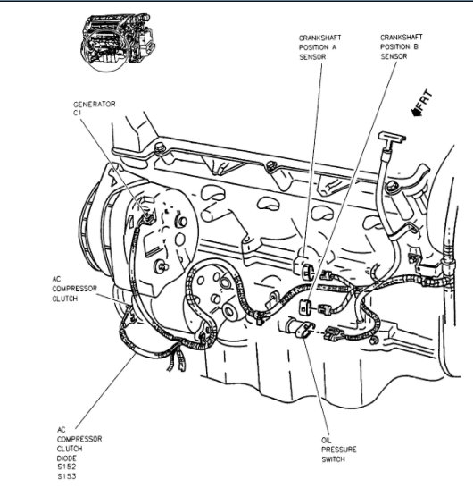

Here is the information you requested. You have 2 crankshaft position sensors on your vehicle sensor 'A' and sensor 'B'. Here are a few tutorials for you to view on how to change a crankshaft position sensor and related symptoms:
I've attached a few picture steps below on how to replace a crankshaft position sensor including their locations on your car. Hope this helps and thanks for using 2CarPros.
