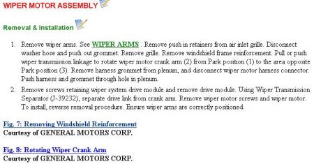

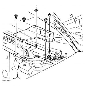

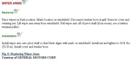

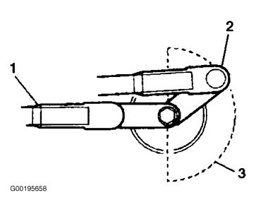

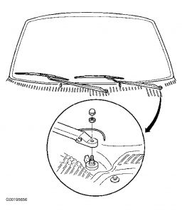

2002 Cadillac Deville 89,000
WABUTCHELLIS
MEMBER
2002 CADILLAC DEVILLE
How do you replace the wiper motor?
Saturday, February 21st, 2009 AT 9:45 PM
ZACKMAN
MECHANIC
4,202 POSTS
SPONSORED LINKS
Saturday, February 21st, 2009 AT 10:19 PM
