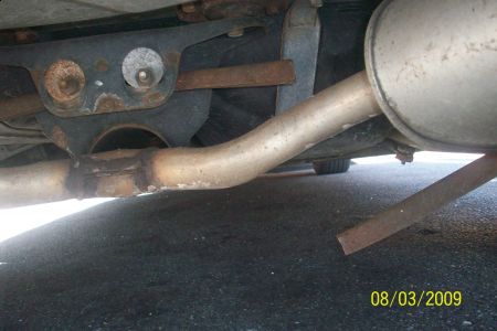

HI, THANK U FOR UR TIME. SOMETIMES MY CAR WILL MAKE A CLICKING SOUND WHEN I GO OVER A BUMP ETC. AND I LOOKING UNDERNEATH AND REALIZED FROM THE BACK THERE IS A STEEL BAR THAT IS BROKE IN HALF AND THE RIGHT HALF OF IT IS HANGING LOWER. WHAT IS THAT, AND WHAT SHOULD I DO. WOULD BE EASY AND CHEAP PLEASE HELP, THANKS AND HAVE A BLESSED DAY[img:a1b31fa882]http://www.2carpros.com/forum/automotive_pictures/329124_032009_256_1.jpg[/img:a1b31fa882]
[img:a1b31fa882]http://www.2carpros.com/forum/automotive_pictures/329124_032009_256_2.jpg[/img:a1b31fa882]

Broke RH rear tie rod. This will affect tire wear, and vehicle handling. I would have it replaced and aligned ASAP.
