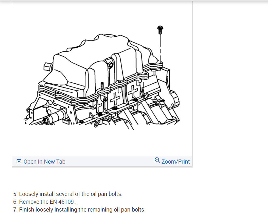

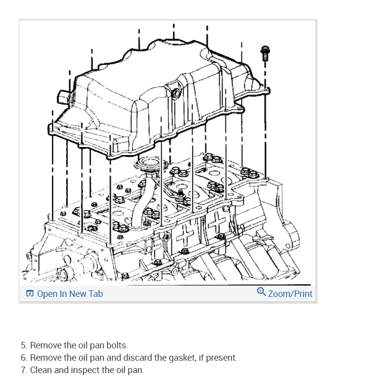

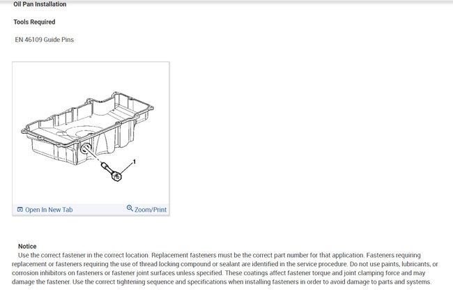

I am working on a friends car and have done just about everything I could to get the oil pan gasket off of the car. I took out the 13 10mm bolts but there is a 13mm bolt on the rear right corner of the oil pan which is impossible to get to because of the transmission. All website I have been on talk about the 13 bolts I have already taken off but no mention of the 13mm bolt that is out of reach.

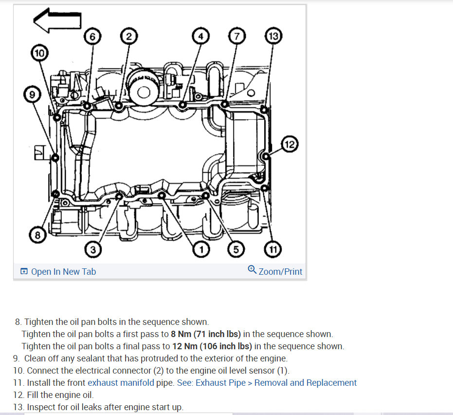

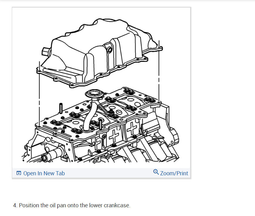

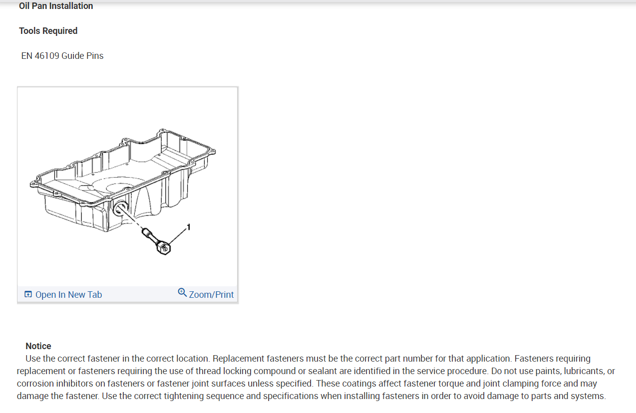

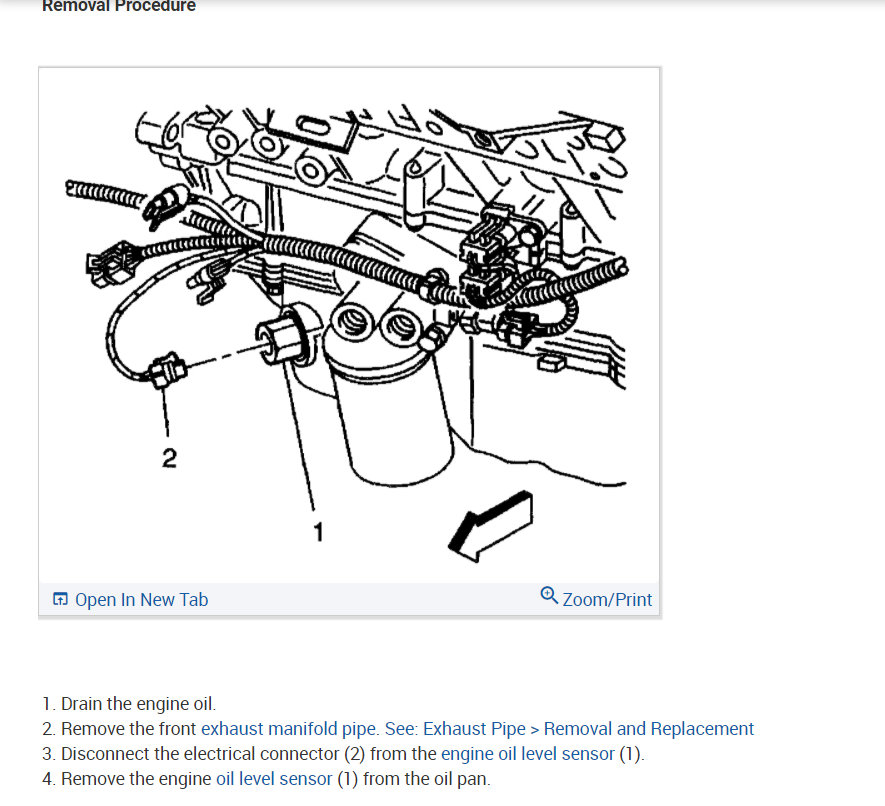

Good afternoon,

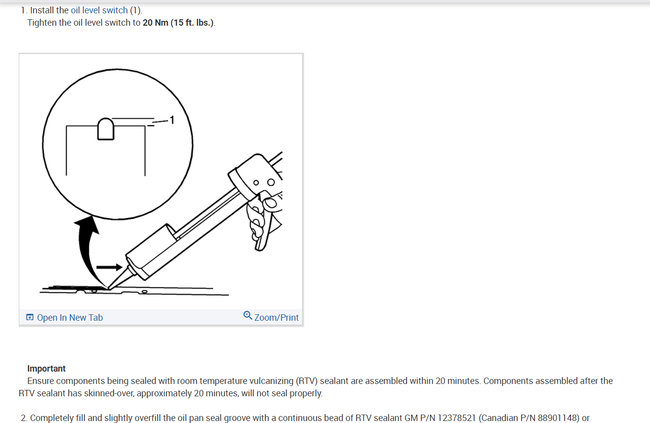

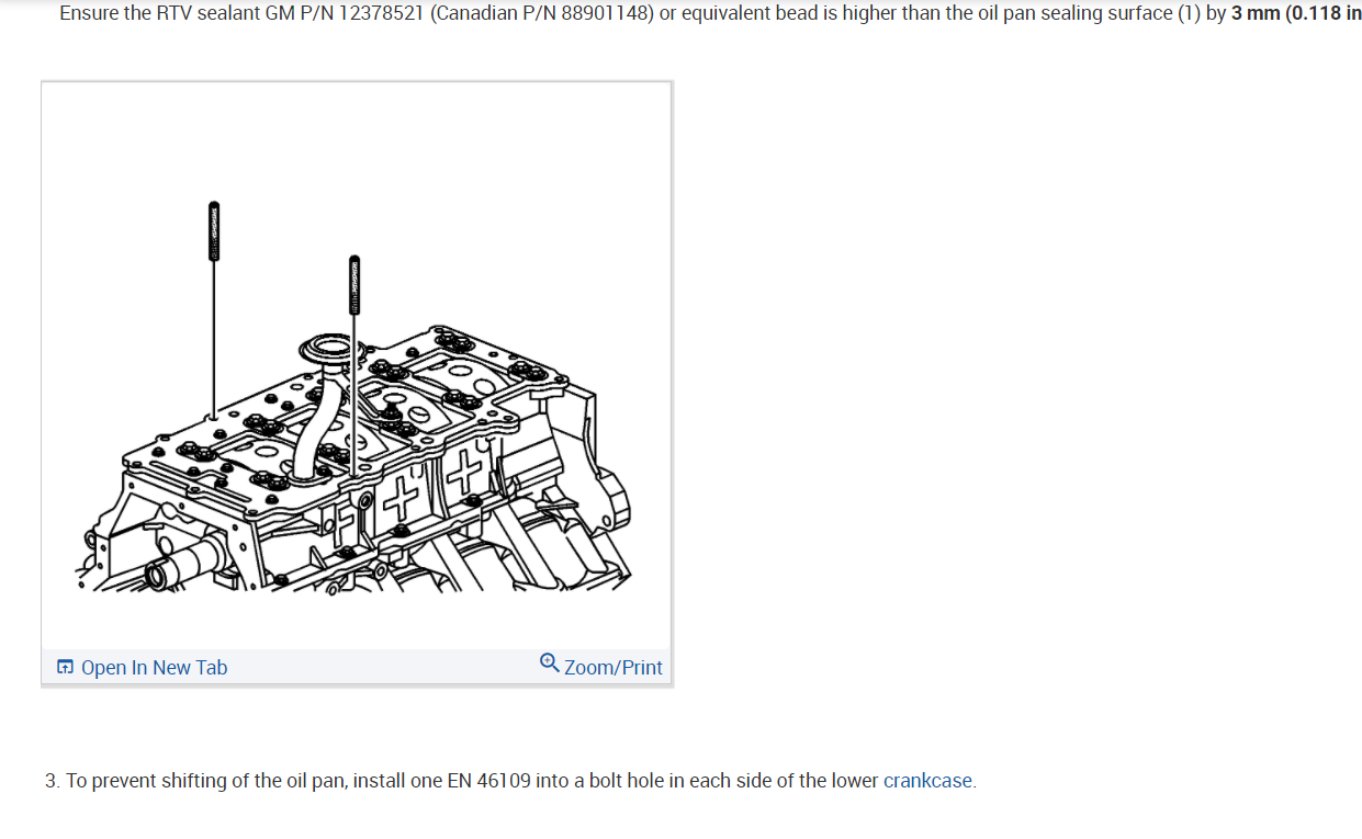

There are only 13 bolts that hold the pan. I attached the procedure for you below and one of the pictures shows the number of bolts securing the pan to the block.
Can you attach a picture of the bolt you think is holding the pan?
