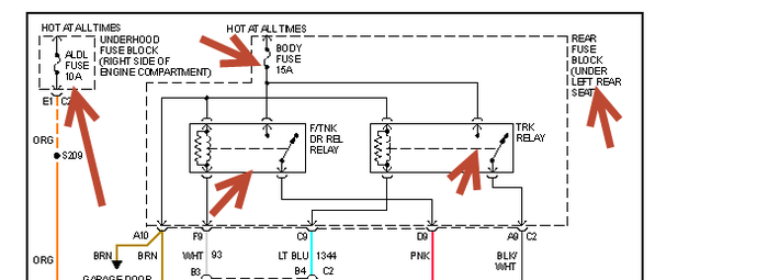

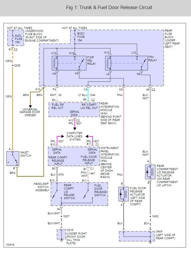

I have a 2000 Deville and cant open the trunk ,gas door from the remote or the release button in the car whats the problem
Jun 1, 2008 at 9:12 AM
  • 55,065 POSTS

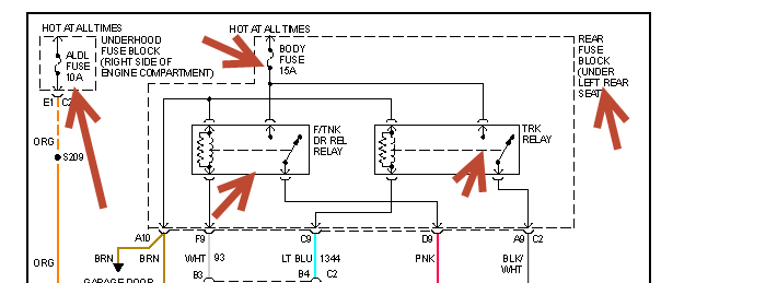

There is a body fuse 15 amp that has blow, replace it and your problem will be fixed. Here is a wiring diagram so you can see for yourself and a guide to help you test the fuse.
Please let us know what you find ;)

A very simple question. I have a 1996 Sedan DeVille. The electric gas door release and the electric trunk release both failed at the same time. I assume that they share a common fuse, but I cannot find anything labeled for these features in the fuse block under the hood. Which fuse is it?

Check the 20Amp fuse labled convenc in the trunk fuse box.

First, a very simple check to add, the valet switch in the glove box that will disable both these features if it is in the off position.
