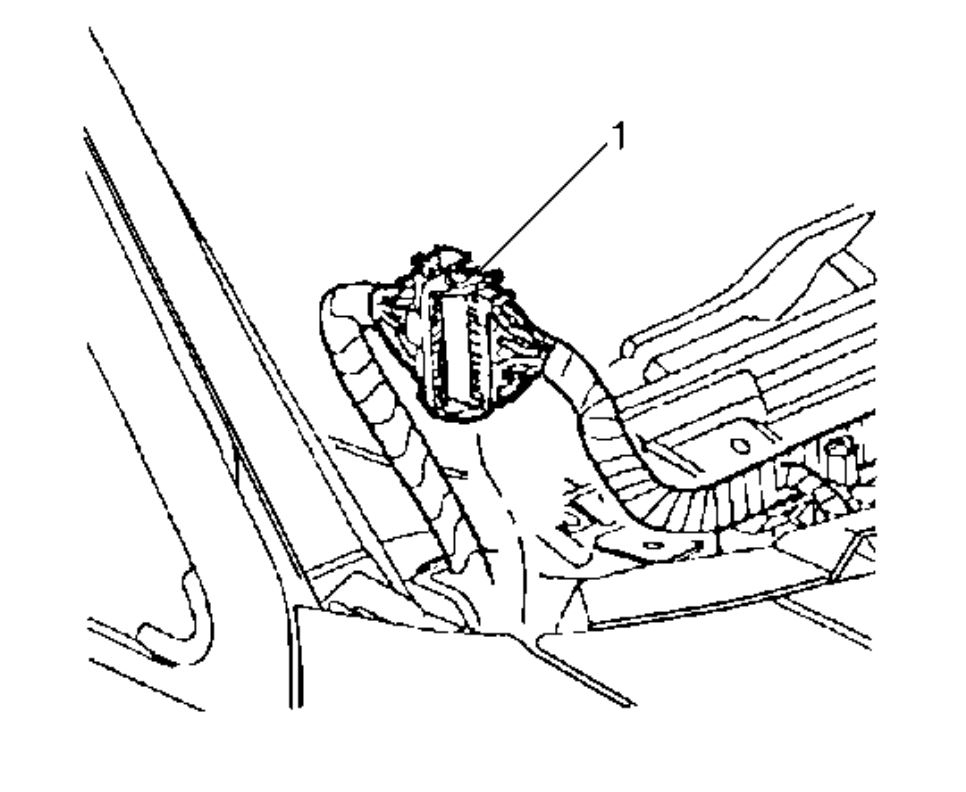

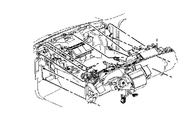

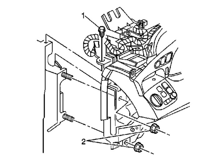

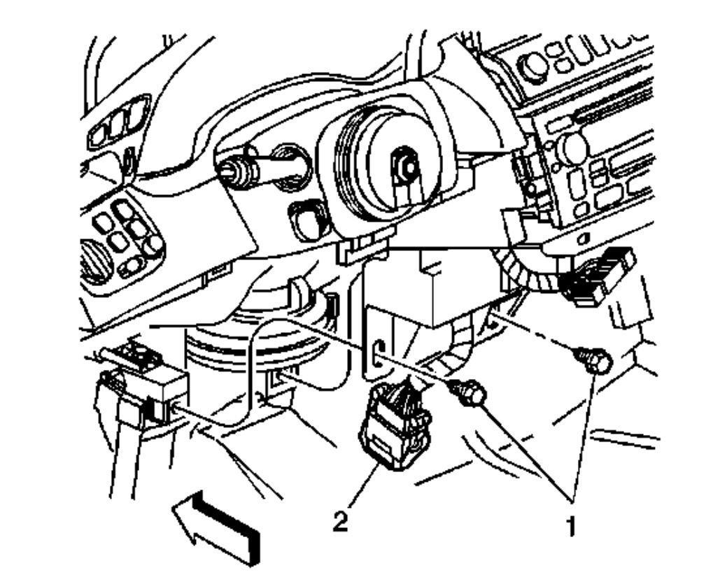

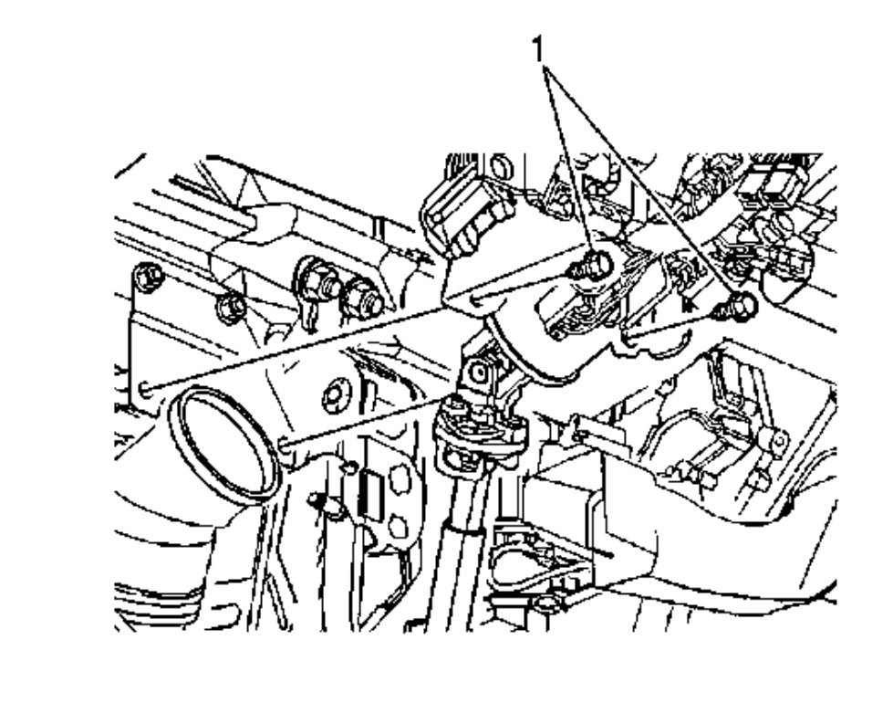

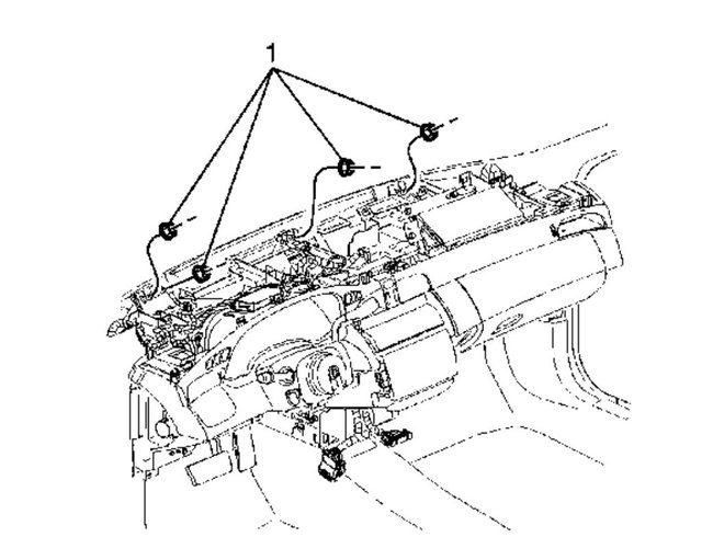

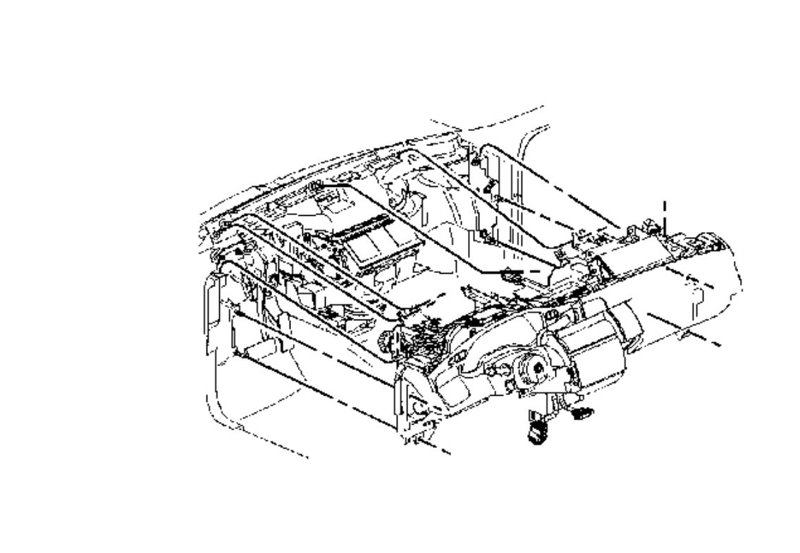

How do you remove the heater core. what do you have to remove to get it out. How much work is it. Thank you

Instrument Panel Assembly Removal
Removal Procedure
Caution: Refer to SIR Handling Caution in Cautions and Notices.
1. Disable SIR. Refer to Disabling the SIR System.
2. Remove the left knee bolster. Refer to Driver Knee Bolster Replacement (Without UV2) (See: Knee Diverter > Procedures > Knee Bolster Replacement - Driver (Without UV2))Driver Knee Bolster Replacement (UV2) (See: Knee Diverter > Procedures > Knee Bolster Replacement - Driver (With UV2)) .
3. Remove the left knee bolster support. Refer to Driver Knee Bolster Bracket Replacement (See: Knee Diverter > Procedures > Knee Bolster Bracket Replacement - Driver) .
4. Remove the right knee bolster. Refer to Passenger Knee Bolster Replacement (See: Knee Diverter > Procedures > Knee Bolster Replacement - Passenger) .
5. Remove the IP center storage compartment or the floor console. Refer to Instrument Panel Compartment Replacement (Base and DHS) (See: Glove Compartment > Removal and Replacement > Instrument Panel Compartment - Replacement (Base and DHS))Instrument Panel Compartment Replacement (DTS) (See: Glove Compartment > Removal and Replacement > Instrument Panel Compartment - Replacement (DTS)) or Front Floor Console Replacement (DTS, w/o UV8) (See: Console > Removal and Replacement > Front Floor Console Replacement (DTS, w/o UV8))Front Floor Console Replacement (DTS, UV8) (See: Console > Removal and Replacement > Front Floor Console Replacement (DTS, UV8)) .
6. Remove the IP endcaps. Refer to Instrument Panel Outer Trim Cover Replacement - Right Side (See: Dashboard / Instrument Panel > Removal and Replacement > Instrument Panel (IP) - Outer Trim Cover Replacement - Right) and Instrument Panel Outer Trim Cover Replacement - Left Side (See: Dashboard / Instrument Panel > Removal and Replacement > Instrument Panel (IP) - Outer Trim Cover Replacement - Left) .
7. Remove the windshield pillar trim. Refer to Windshield Pillar Garnish Molding Replacement (Standard) (See: Trim Panel > Removal and Replacement > Windshield Pillar Garnish Molding Replacement (Standard)) in Interior Trim.
8. Remove the defroster grille. Refer to Defroster Grille Replacement (Without UV2) (See: Dashboard / Instrument Panel > Removal and Replacement > Defroster Grille Replacement (Without RPO Code UV2))Defroster Grille Replacement (UV2) (See: Dashboard / Instrument Panel > Removal and Replacement > Defroster Grille Replacement (With RPO Code UV2)) .
9. Remove the IP upper trim pad. Refer to Instrument Panel Upper Trim Pad Replacement (See: Dashboard / Instrument Panel > Removal and Replacement) .
10. Remove the heads up display, if equipped with UV8. Refer to Head Up Display Module Replacement.
11. Disconnect the body to IP electrical connectors (1) at the top, outside corners of IP.
12. Disconnect all other electrical connectors from the IP to body.
13. Disconnect the steering column shaft from the steering column.
14. Remove the steering column to body fasteners (1).
15. For a DeVille base model, or the DeVille DHS, disconnect the shift cable from the steering column.
16. Disconnect the Steering column to body connectors.
17. Remove the IP center support bracket fasteners (1) to floor bracket.
18. Remove IP carrier (1) to cowl fasteners.
19. Remove the fasteners (1,2) from the left and right IP carrier to hinge pillar.
20. Remove the IP and carrier assembly from the vehicle.
This will get you to the HVAC plenum so you can remove the heater core
'See pics below

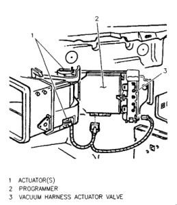

The heater core is located inside of the heater and evaporator module, in dash behind glove box compartment.
REMOVAL:
Disconnect the negative battery cable.
Drain and recycle the engine coolant.
Disconnect the heater core hoses using tool J-37097 or equivalent.
Remove the right side sound insulator and the glove box module.
Remove the programmer shield, if equipped, and disconnect the air mix valve link.
Disconnect the programmer vacuum and electrical connectors.
Remove the heater core cover, leaving the programmer attached.
Remove the heater core retaining screws and the heater core.

1.Disconnect battery ground cable. 2.Remove glove box attaching screws, then the glove box. 3.Remove lower sound insulator attaching screws and nuts, then the lower sound insulator. Heater And A/C Programmer And Actuators
https://images.2carpros.com/forum/automotive_pictures/12900_hc_10.jpg
4.Remove programmer as follows: a.Remove programmer shield attaching screws, then the programmer shield. b.Disconnect threaded rod from programmer. c.Disconnect programmer electrical and vacuum connector, then remove programmer. 5.Disconnect body control module electrical connector, then remove module attaching screws and module. 6.Remove relay panel from module assembly, then the module assembly heater core cover. 7.Disconnect heater hoses from heater core. 8.Remove two heater core attaching screws, then the heater core. 9.Reverse procedure to install. https://www.2carpros.com/kpages/auto_repair_manuals_alldata.htm
