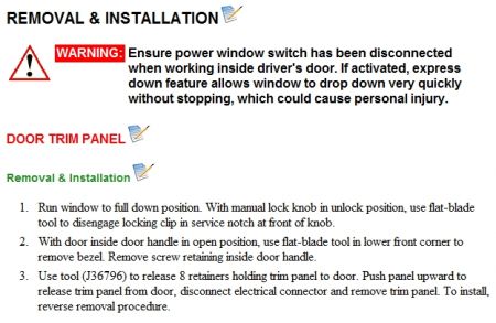

How do i remove the door panels to a 2000 Cadillac Deville?
