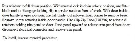

How do i remove the passenger door panel

https://images.2carpros.com/forum/automotive_pictures/261618_Noname_2249.jpg
