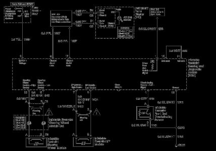

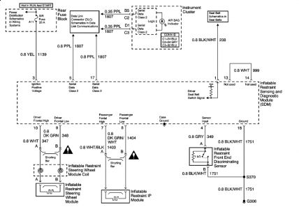

r.seat bag deployed , hit a large rock and blew r. front tire. module gives airbag light. i have airbag and module to install. i have disconnected bat, removed module. now do i install the r. seat bag and then install module? is the 2000 and 2001 have the same module?
Oct 29, 2009 at 4:49 PM
MATHIASO
  • 1,209 POSTS
according to both 2000 and 2001 diagrams, they look like ( same) here is 2000

here is 2001
https://images.2carpros.com/forum/automotive_pictures/46384_2001a_1.jpg
sending them in your email too
