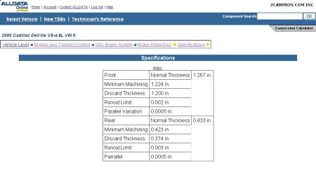

Getting brake pulsation problems after replacing the brake rotors with aftermarket rotors. When checking the rotor runout I am getting a .003" run out on the outside of th disc and a .005" run out on the inside of the disc. What is the runout tolerance for the front and rear rotors?

See below
https://images.2carpros.com/forum/automotive_pictures/12900_rotor_thickness_1.jpg
