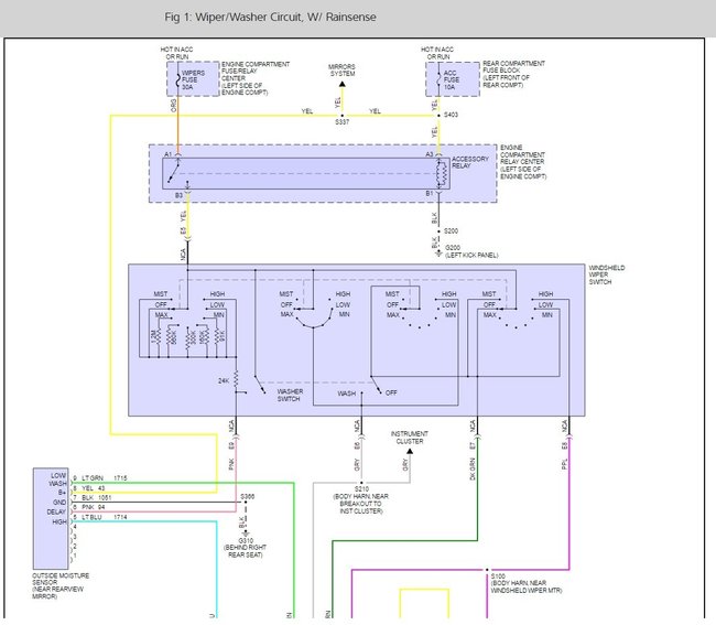

Is there a wiper motor relay on a 99 Cadillac Deville? I have replaced the motor and the circuit board and it still will not work. I have also replaced the fuse under the hood.
Feb 5, 2009 at 12:34 PM
  • 55,421 POSTS
Hello there,

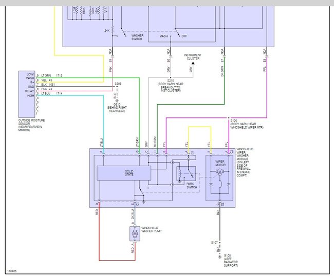

Here is the location and the wiper wiring diagrams so you can do some testing.
there is also a rain sensing unit that could be causing the trouble as well.

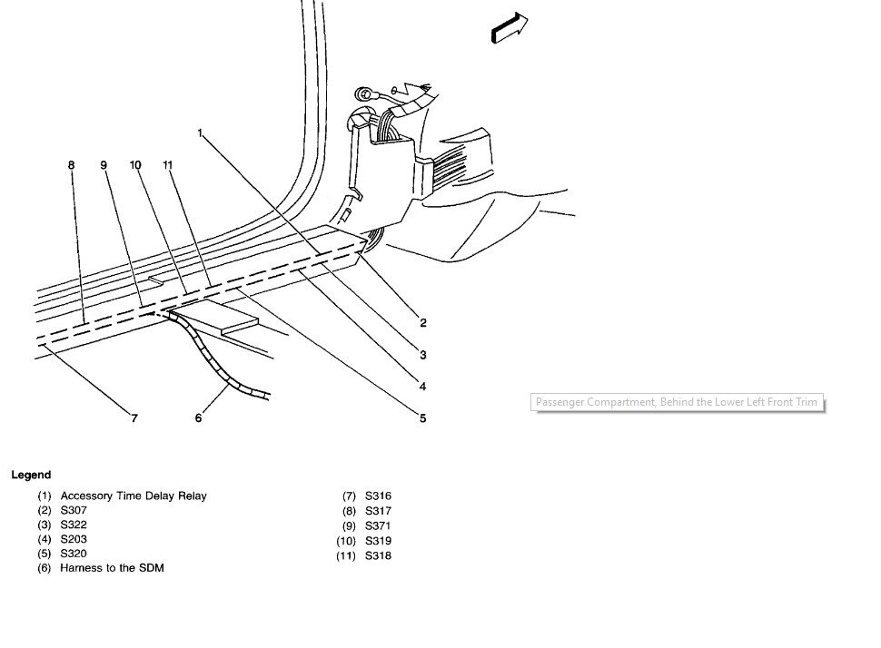

Here is a guide to help test the relay which is under the passengers seat.
Please let me know if you need anything else to get the problem fixed.
Best, Ken
