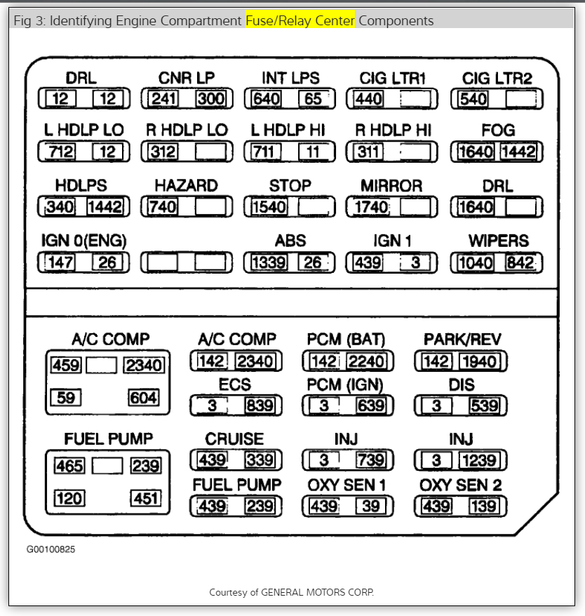

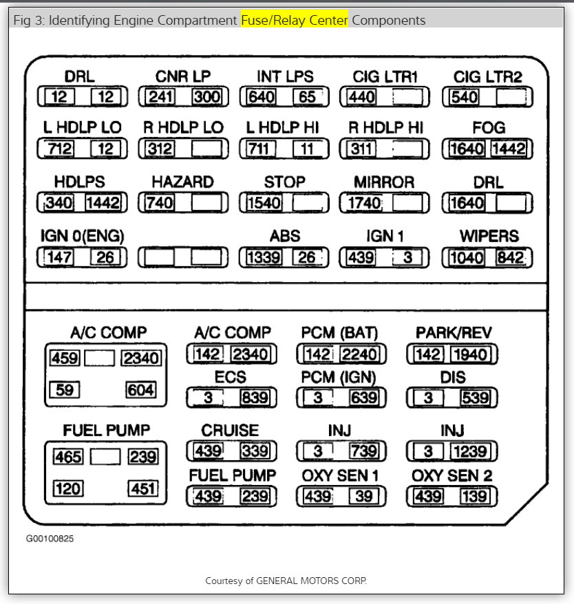

Cannot get the starter to engage. Have cleaned all terminals & replaced the battery. When I turn the switch I get nothing. I have tried the second set of keys. I love this site
May 15, 2010 at 3:48 AM
  • 55,433 POSTS

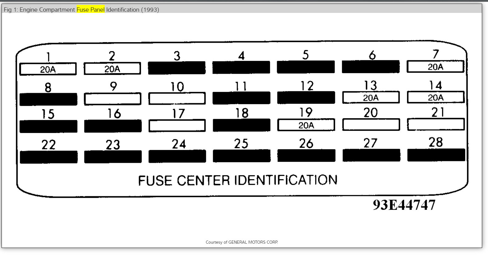

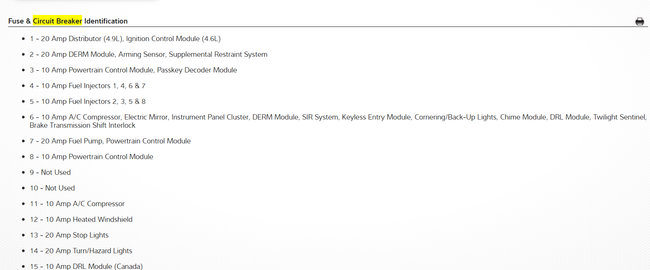

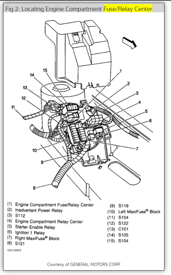

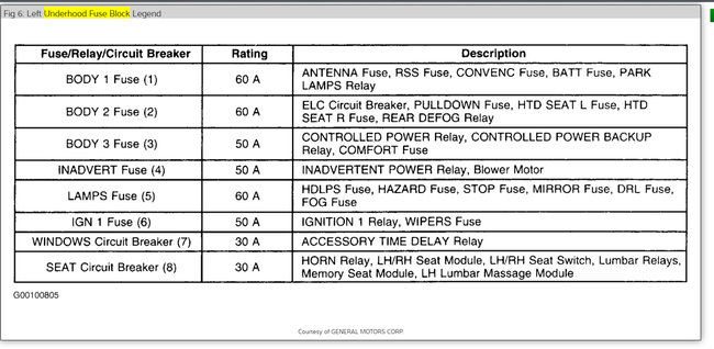

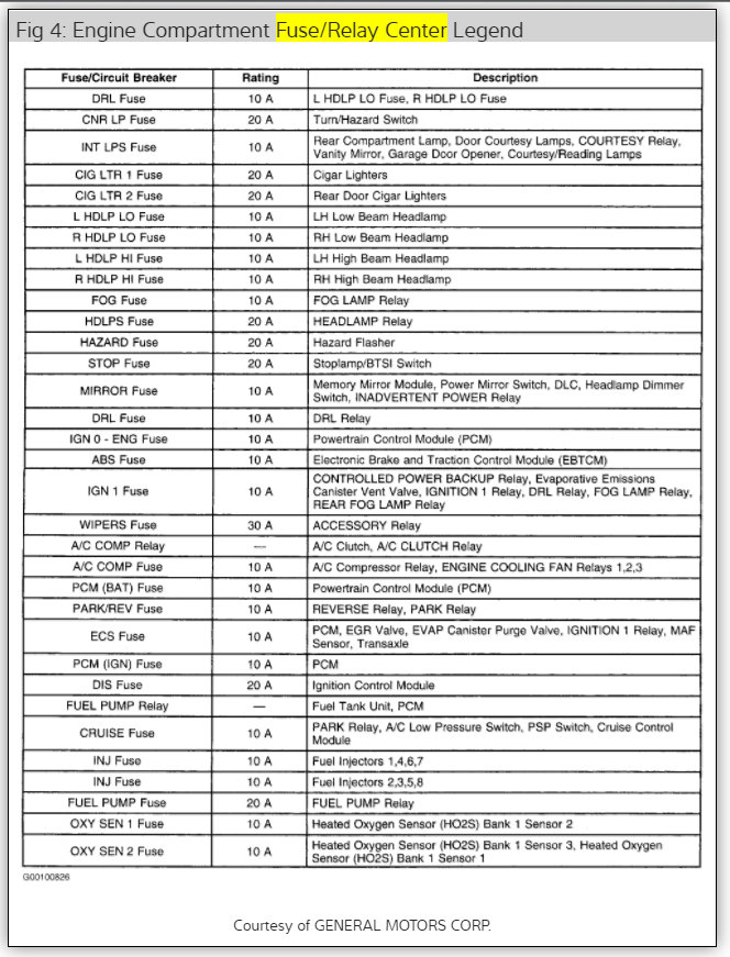

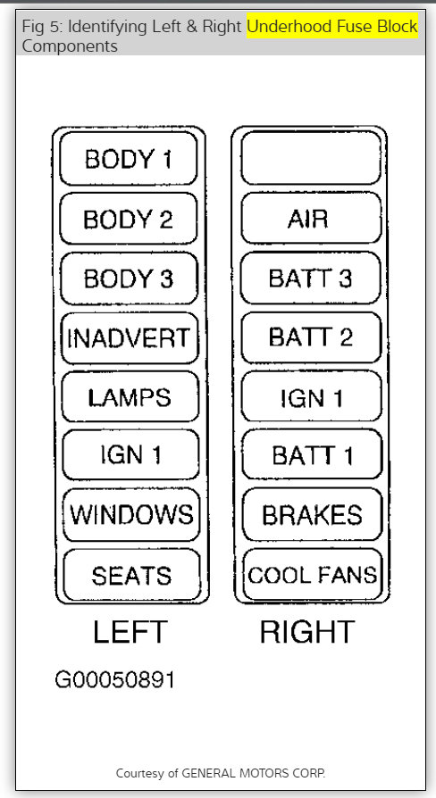

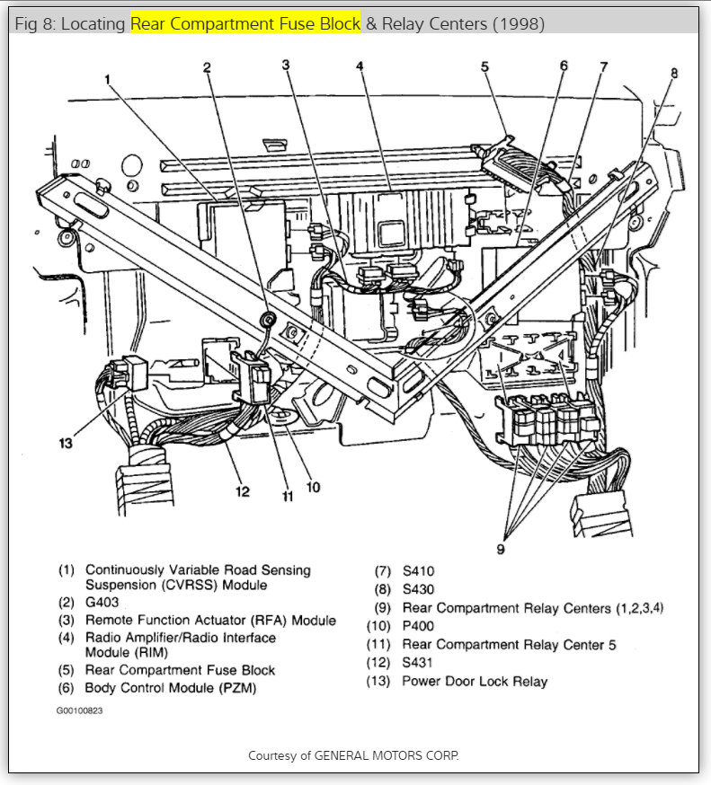

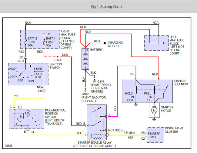

Yep there is a starter relay under the hood on the left side of the engine compartment. I would check the entire circuit here is a couple of repair guides that will help you see whats going on and test the relay.
and

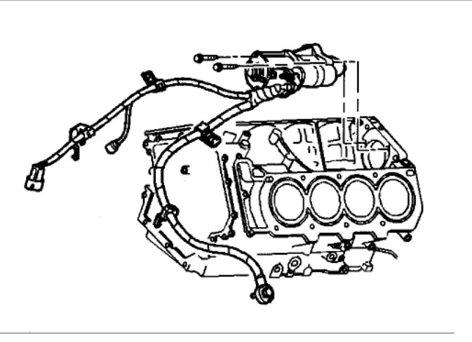

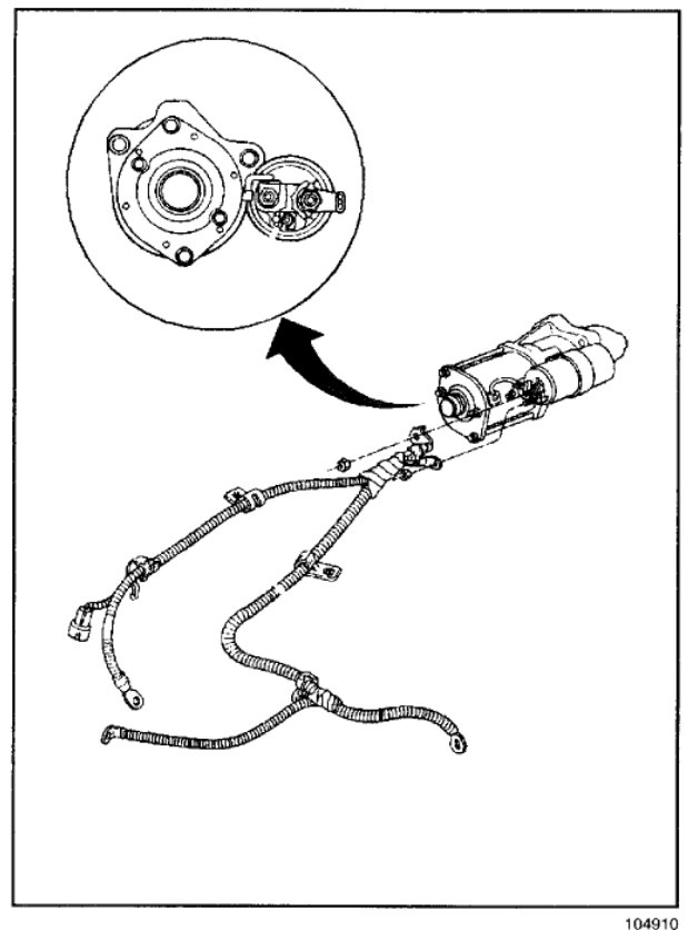

If the starter turn out to be bad here is a guide that will help you test and replace the starter.
The starter in your car is under the intake manifold.

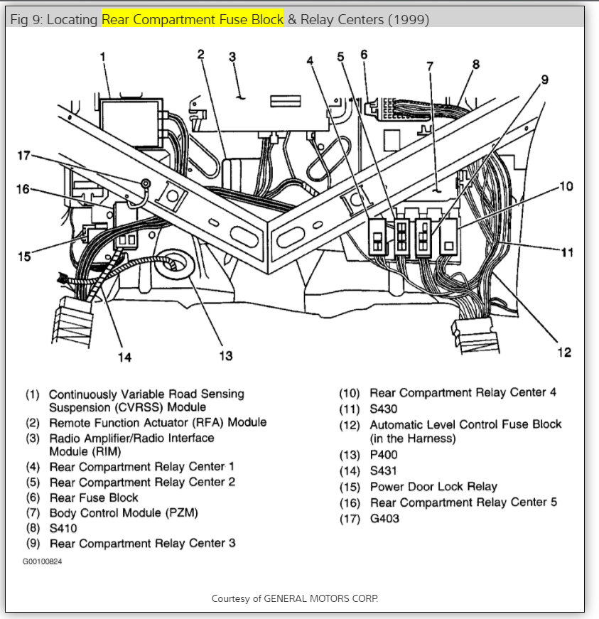

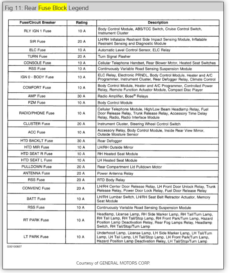

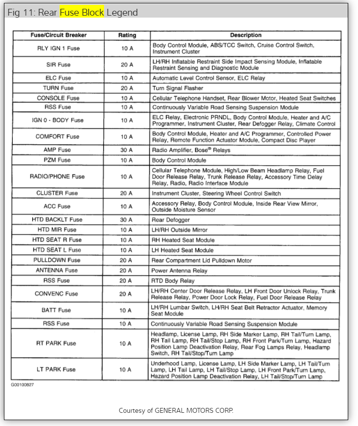

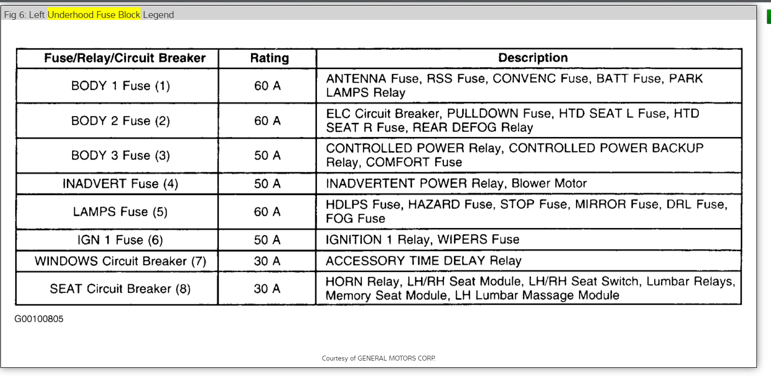

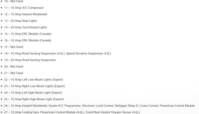

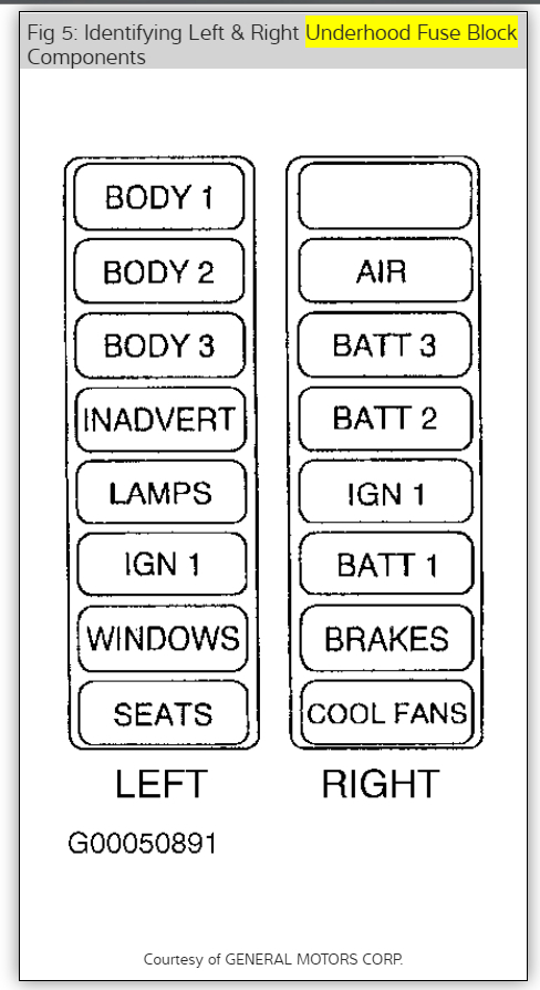

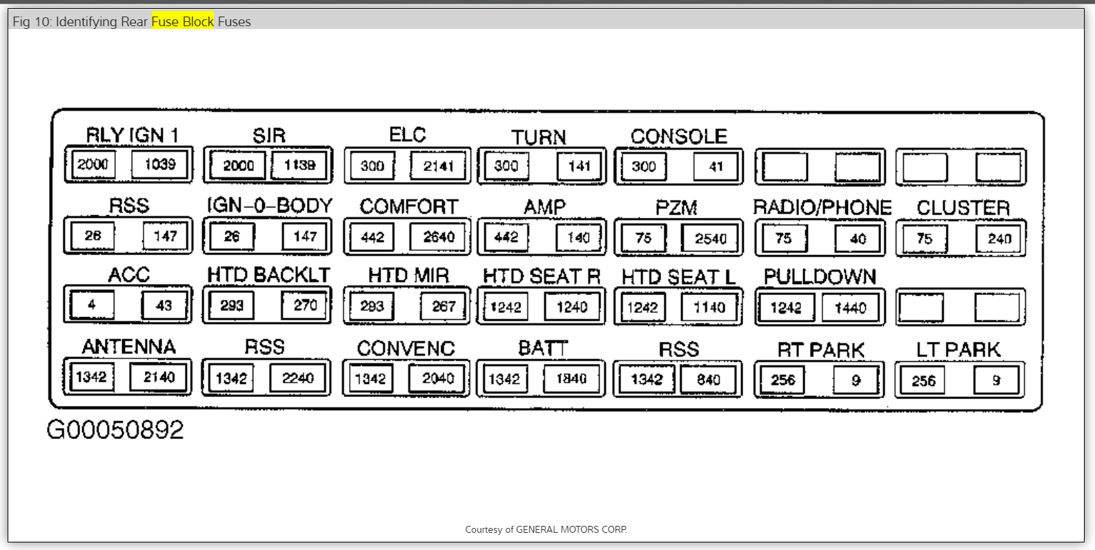

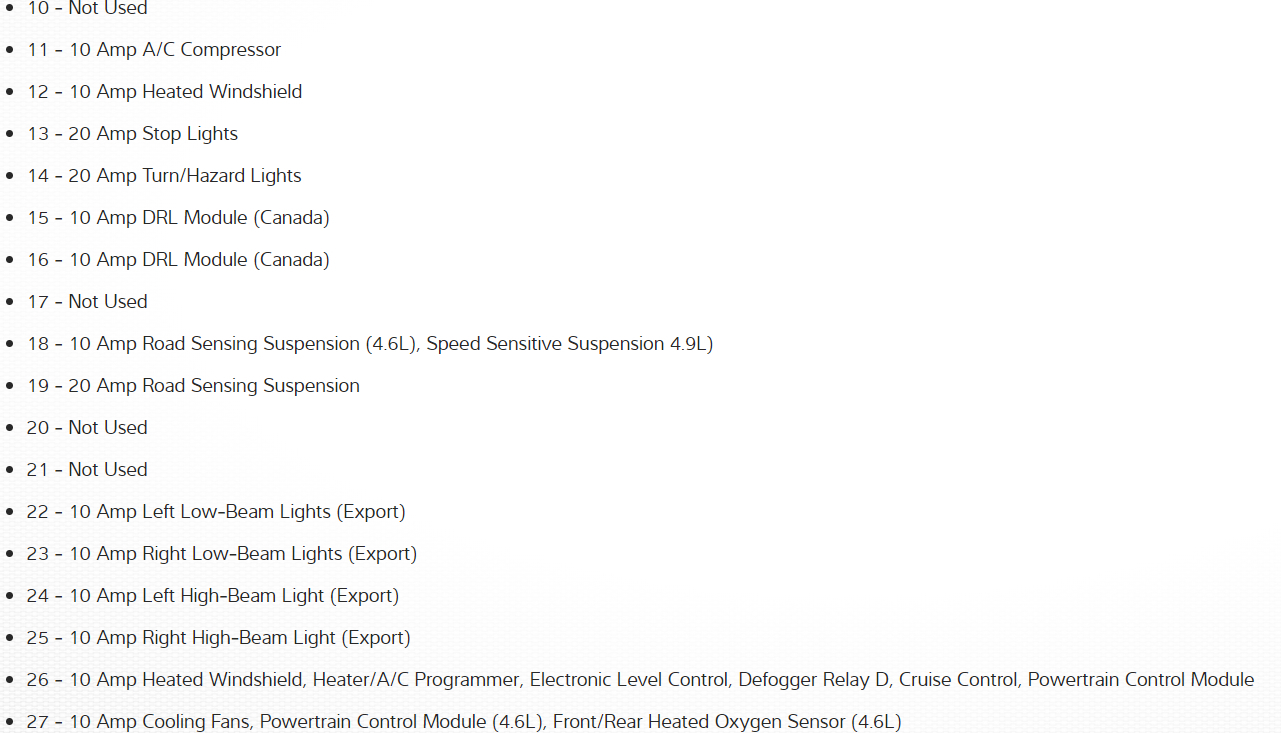

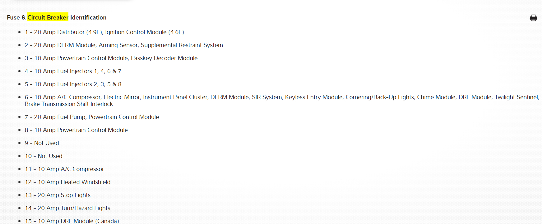

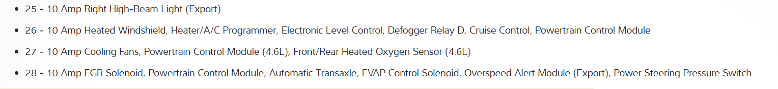

Here are the start wiring diagrams and fuse and relay locations (below)
