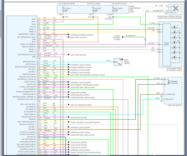

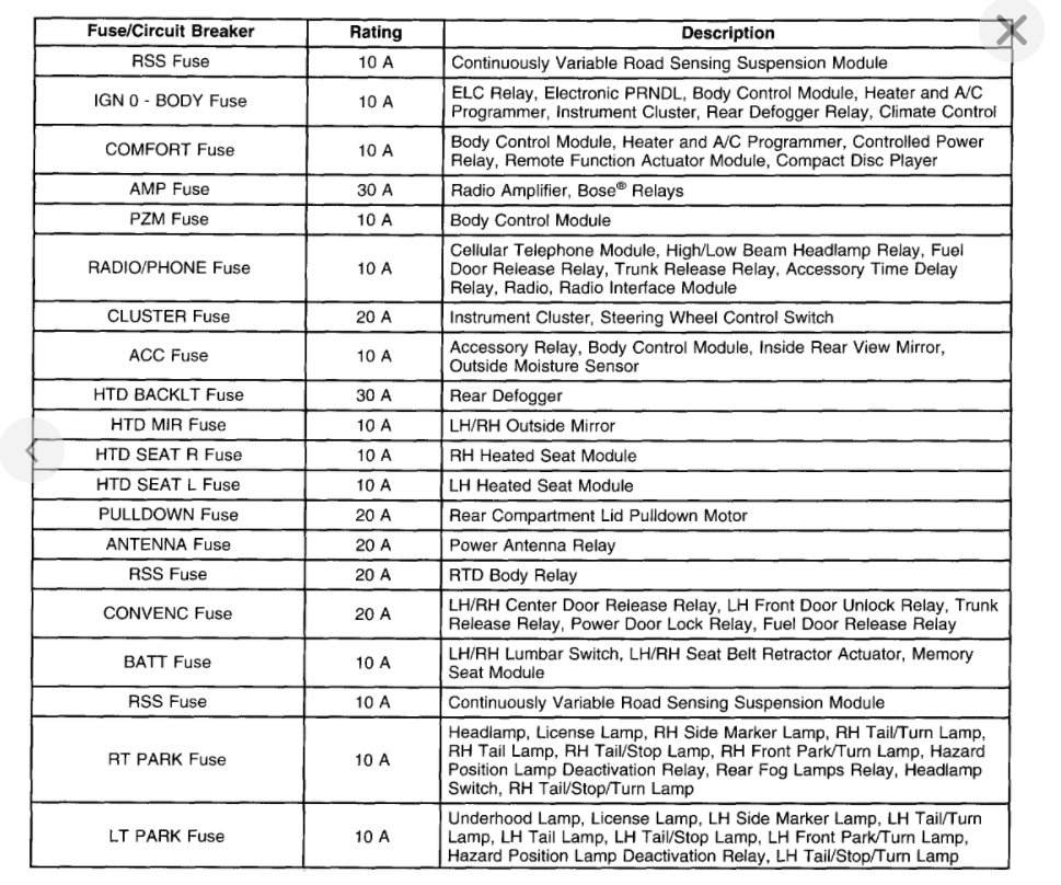

While driving my dash board suddenly went out. Due to the dash board going out; I can't see the speed odometer, fuel amount, etc. What causes this issue?
Aug 10, 2010 at 2:42 PM

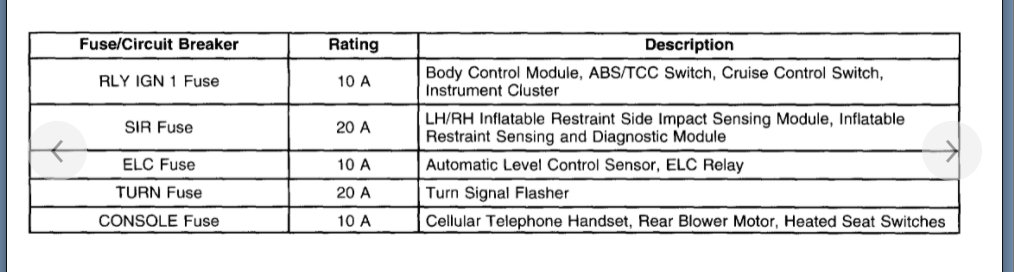

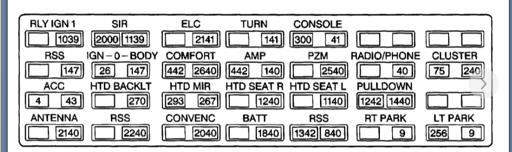

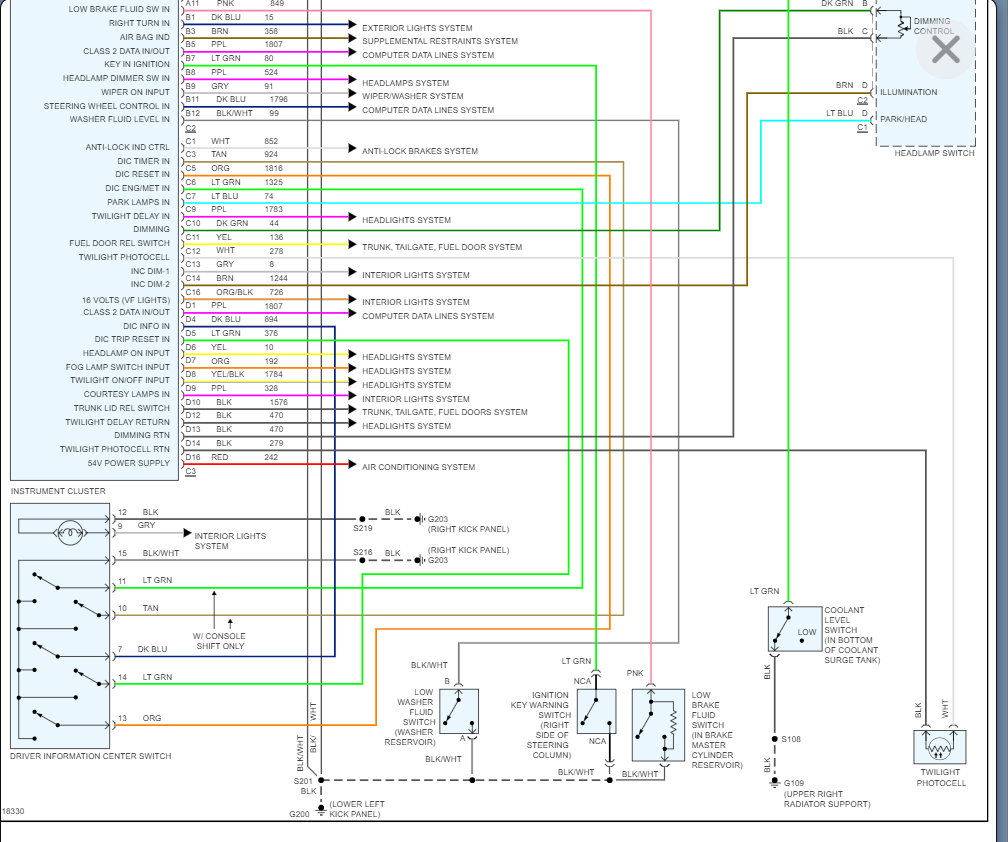

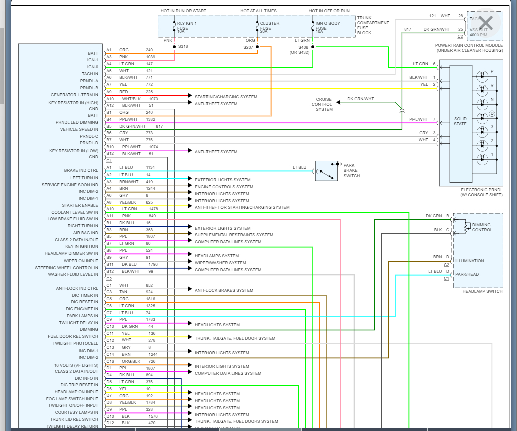

More than likely this is just the illumination circuit for this cluster. So, we need to start by checking the power on the fuse for the cluster.
I am attaching the wiring diagram that helps with this.

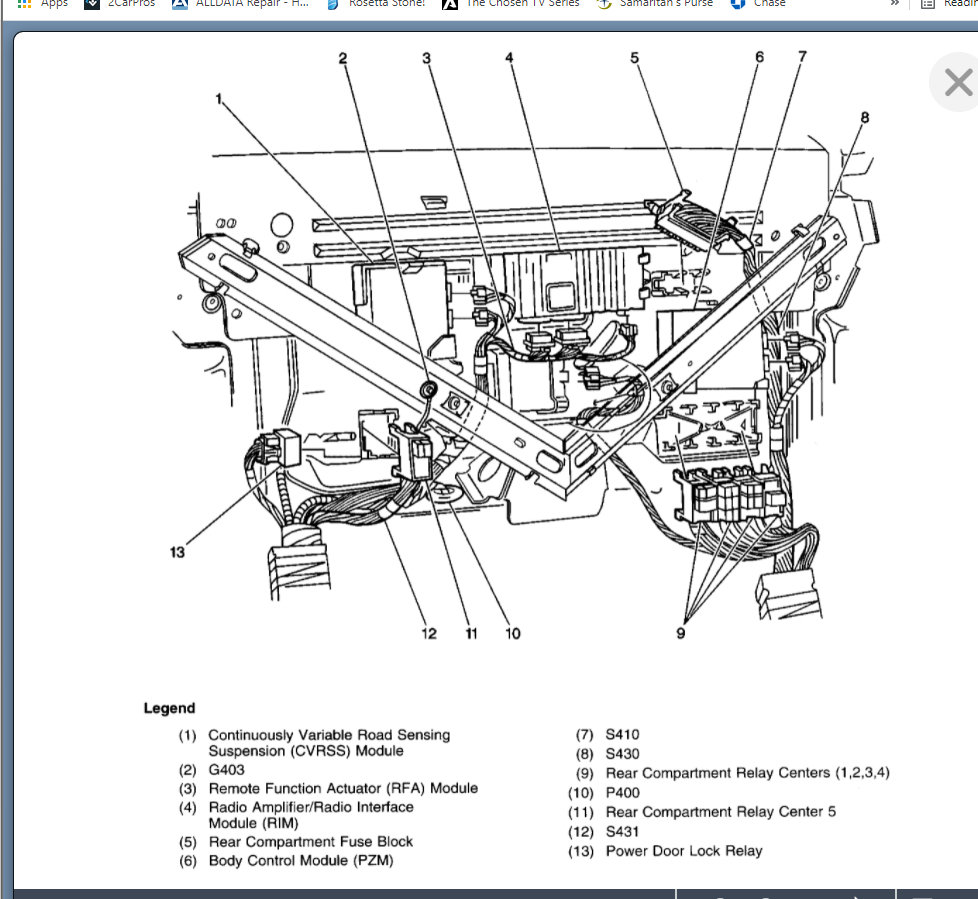

However, here are a couple of guides that will help with this:
Please see the info below on the wiring diagram and the fuse panel info.
Let us know what you find, and we can go from there. Thanks
