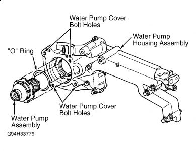

Engine Cooling problem
1998 Cadillac Deville V8 Front Wheel Drive Automatic
where is it located on the nothstar engine. how to replace.

Water Pump Remover/Installer (J-38816) is required to turn pump assembly. Drain cooling system. Move engine torque strut for access. Remove air cleaner. Remove water pump belt cover (4 bolts). Remove water pump drive belt, by-pass hose, lower hose and pump cover. Using Remover/Installer (J-38816), rotate water pump assembly clockwise, and remove from vehicle
https://images.2carpros.com/forum/automotive_pictures/99387_Graphic1_677.jpg
