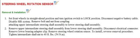

We have a 1998 Cadillac DeVille,we are replacing the steering center sensor. How do we install it correctly,centered on steering shaft. We are trying to fix a code C1283. aLL HELP WOULD BE GREATLTAPPRECIATED. THANK YOU

https://images.2carpros.com/forum/automotive_pictures/261618_Graphic_689.jpg
https://images.2carpros.com/forum/automotive_pictures/261618_Noname_2674.jpg
