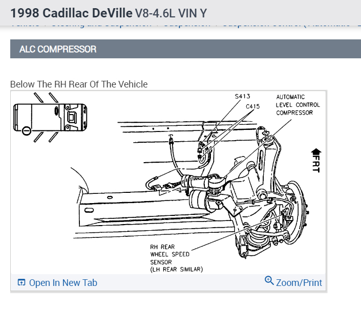

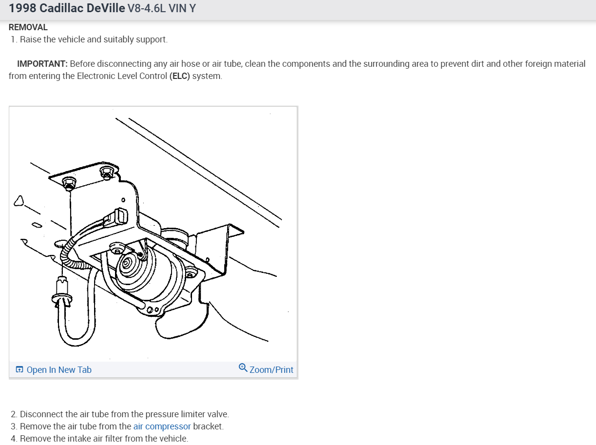

LOCATION OF THE AIR RIDE COMPRESSOR?
100,770 MILES • V8 • FWD • AUTOMATIC
DET1957
please tell me where to find the air ride compressor.
May 1, 2009 at 1:31 PM
SQM
  • 6,383 POSTS

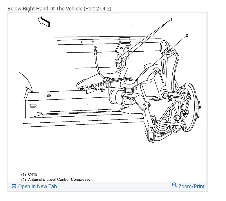

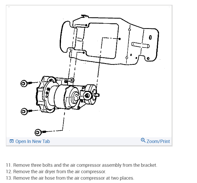

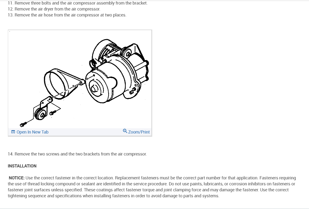

The air ride compressor is located below the rear right hand side/passenger side of the vehicle. I have attached the location diagram, see below.

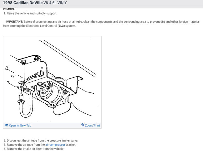

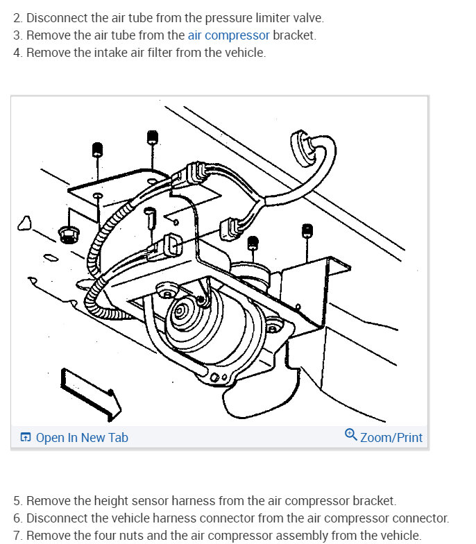

Keep in mind, before disconnection any of the air hoses or tubes be sure to clean the surrounding area to prevent dirt or debris entering the system.

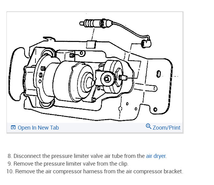

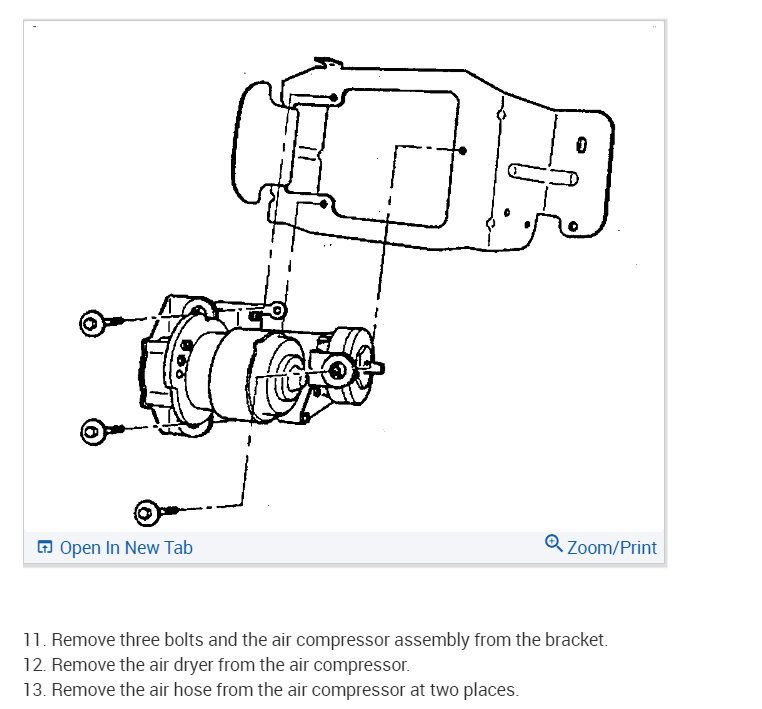

I have attached the replacement instructions for your reference.
Check out the images (Below). Please let us know if you need anything else to get the problem fixed.
