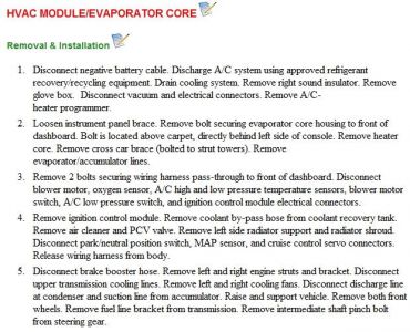

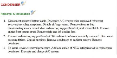

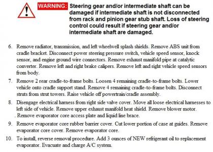

My Mechanic needs to install a new evaporator core and condenser in my car, and I am wondering what all is involved with this process--the dissassembly and reassembly. I'm trying to keep my mechanic honest by knowing a little more about the process. Any assistance would be appreciated.

BLUELIGHTNIN6
  • 16,542 POSTS
https://images.2carpros.com/forum/automotive_pictures/261618_Noname_2287.jpg
https://images.2carpros.com/forum/automotive_pictures/261618_Noname2_751.jpg
https://images.2carpros.com/forum/automotive_pictures/261618_Noname3_276.jpg
May 31, 2010 at 6:22 AM
