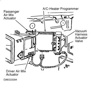

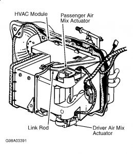

How do you get to the heatercor to replace it?
Friday, October 23rd, 2009 AT 1:04 PM
DOCFIXIT
MECHANIC
18,828 POSTS
Remove glove box then AC programer
then core cover , drain coolant remove heater hoses. remove heater core. adjustment to air mix valve maybe necessary
