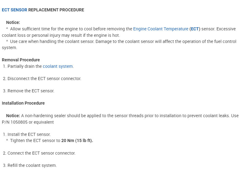

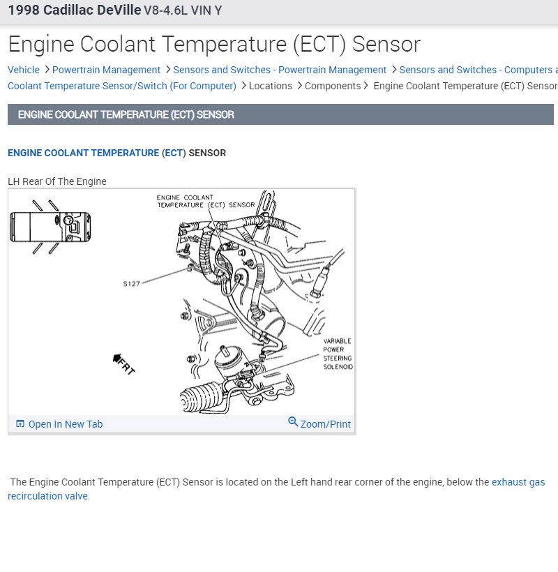

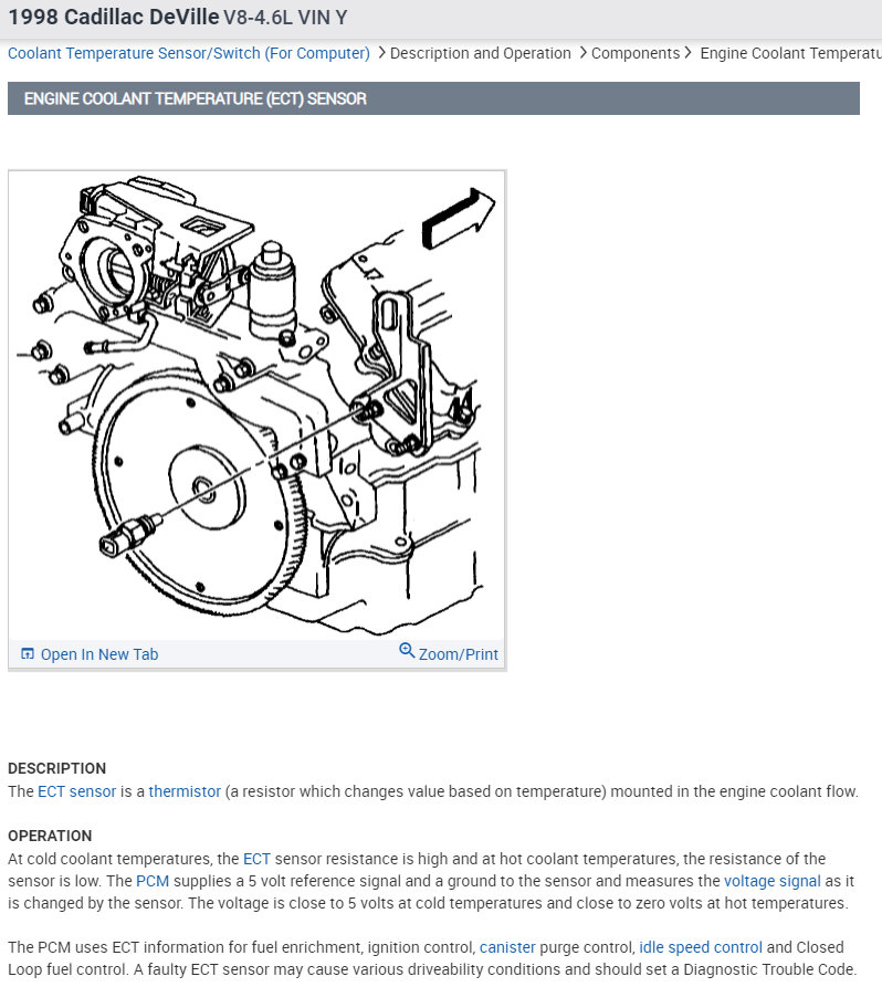

The ECM gets the signal from the coolant temperature sensor. So, if that sensor sends incorrect data to the ECM the fan will not get triggered.
https://www.2carpros.com/articles/how-a-coolant-temperature-sensor-works
Observe the fan for the next few days and keep an eye on the temperature gauge. If it spikes, then there is an issue. If it stays within the operating temperature the fan does not necessarily need to come on.
