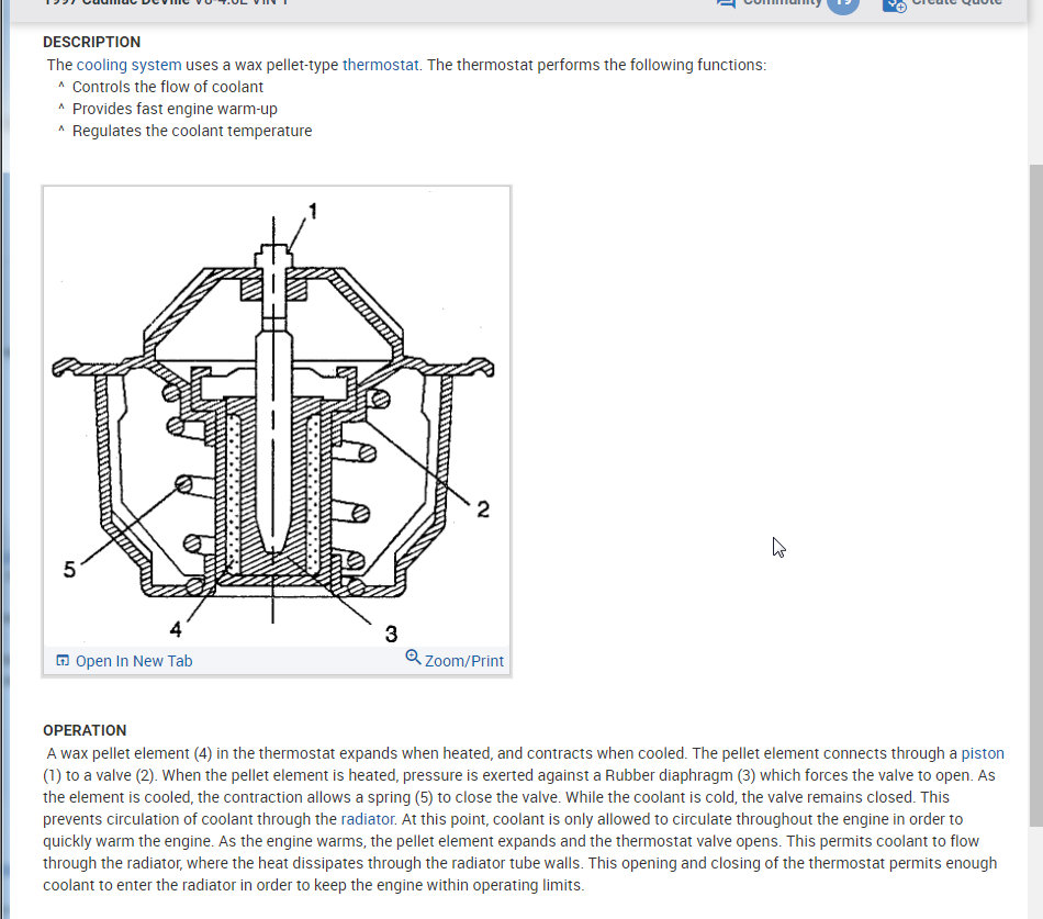

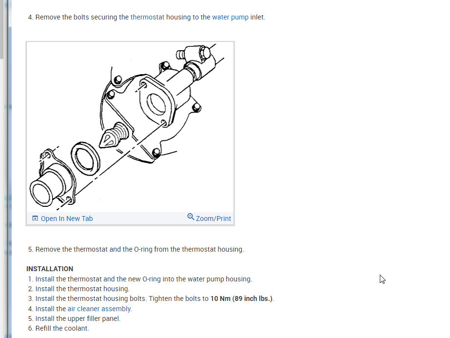

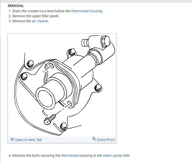

how to locate and replace thermostat
Dec 24, 2008 at 1:59 AM
I am attaching the info on how to replace the thermostat which shows the location of the thermostat.
Also, here is a video that shows how to replace it on a different vehicle but another 4.6L so it gives you more info:
https://youtu.be/MKHnFY4WU8o
Let us know if you need other info. Thanks
