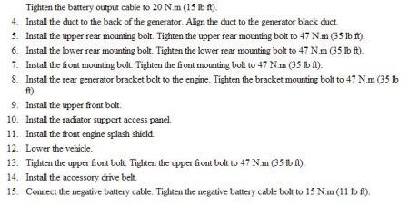

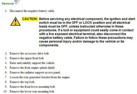

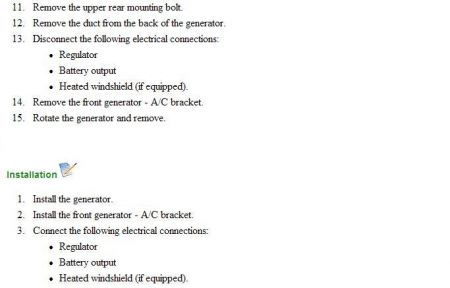

How do you change an altenator on the 97 Northstar engine?
Friday, August 14th, 2009 AT 12:36 PM
BLUELIGHTNIN6
MECHANIC
16,542 POSTS
SPONSORED LINKS
Friday, August 14th, 2009 AT 5:52 PM
