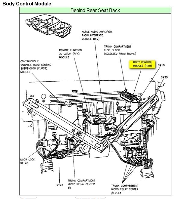

where is the body control module located
Sep 13, 2010 at 8:40 PM
WRENCHTECH
  • 20,761 POSTS
It's located behind the rear seat back.
