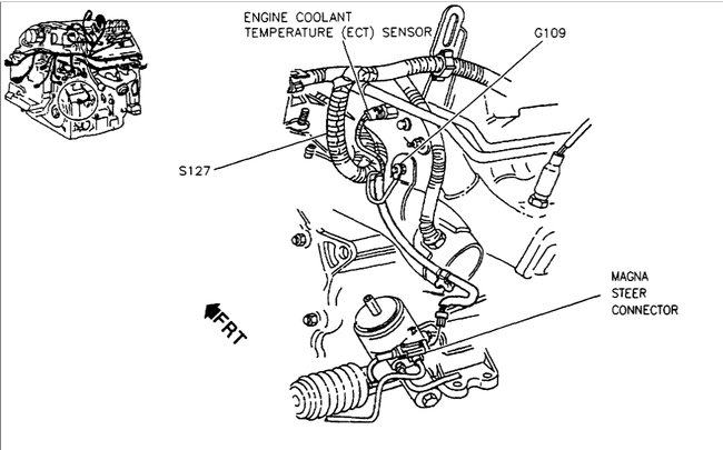

V8 front wheel drive automatic 144,000 miles.
My car starts running rough after driving it for long periods of time it does not really overheat just runs on the hot side around 228. once i stop car and cools down runs fine. have checked the fan does come on does not seem to come on like it should or blow as hard as it should and do not think it is the thermostat because it does not do it all the time. but when it starts running rough it idles really rough the rpm's go up and down and when you press the gas it does not want to go like it is choking. i was told to check the temperature sensor, but i donot know where it is located at or where to even find it.

Hello, Engine coolant temperature (ECT) sensor left rear of engine, near base of rear engine lift hook. Here is a guide that will show you what you are in for when doing the job: https://www.2carpros.com/articles/coolant-temperature-sensor-cts-replacement
https://images.2carpros.com/forum/automotive_pictures/12900_cts_50.jpg
Below is the location. Please let us know what happens. Cheers, Ken

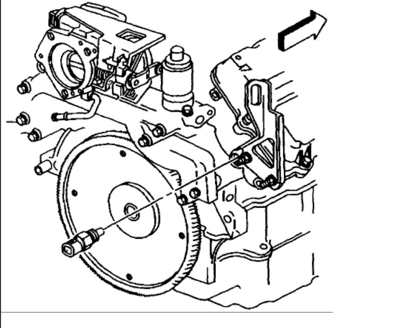

I need to know were the coolant sensor is located.
Nov 5, 2017 at 4:07 AM (Merged)
  • 75,992 POSTS
Description.
https://images.2carpros.com/forum/automotive_pictures/12900_c_17.jpg
In the left rear corner of the engine, below the exhaust gas re-circulation valve.
