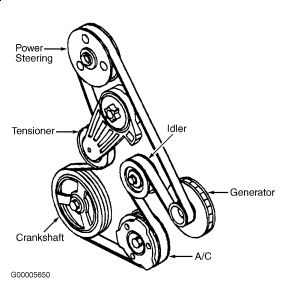

please provide a diagram on how to replace the water pump belt. this car has 3 pulleys on the right side of the engine. I can't seem to get thebelt around all 3 pulleys. Help!!!!!!!!

Need to move tensioner to allow for belt replacement. See square cut hole ? place breaker bar and pull tensioner away. Put belt on then release tensioner.
https://images.2carpros.com/forum/automotive_pictures/198357_Graphic_341.jpg
