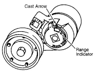

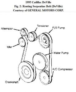

need a diagram of proceedure

Hello !! here you have the route of the belt diagram and the tensioner range. Engines with serpentine belts have automatic tensioner. If tension is not as specified, check belt operating length and tensioner operating range. Replace belt or tensioner as necessary. to replace the belt just release the tension on the tensioner remove the old belt and install the new-one. thanks a lot for your donation !!
