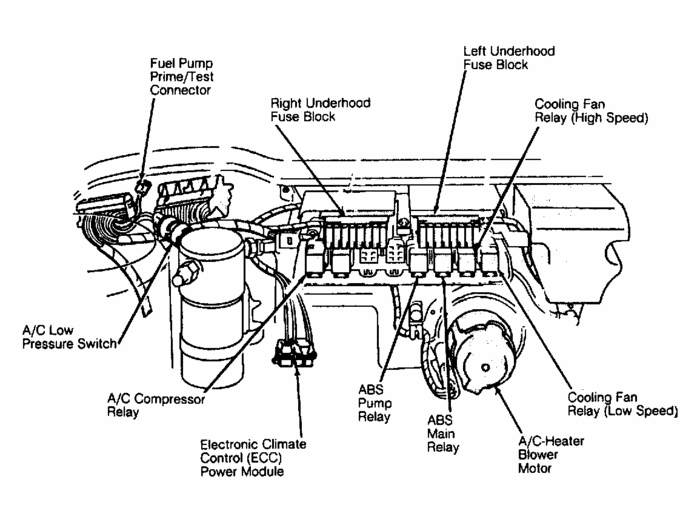

TRULOVE
Have 93 sixty special Cad. LED on ac won't come on. AC blows thru defrost until led comes on. Have noticed when it's cold or humidity is low (not often down here) it will work after car has run for awhile. System regulates to 75 degrees and will work once LED lights up. Fuel gauge does sometimes does the same. Appreciate ANY help I can get.
Jul 21, 2020 at 4:07 AM (Merged)
RIVERMIKERAT
  • 6,106 POSTS
It sounds like you have a low refrigerant issue. Open the hood and start the car. While the engine idles, turn on the AC. See if the clutch engages on the compressor. Check the relays in the system under the hood. High humidity areas cause electrodes to corrode. You might want to use some rubbing alcohol and an old toothbrush to clean the electrical contacts of the relays, switches and connectors.

TRULOVE
Where are the relays, switches and connectors to clean? Thx
RIVERMIKERAT
  • 6,106 POSTS
Refer to the attached image. The relays are (facing the engine from the front) at the right rear of the engine compartment.
The compressor coil connector is on the front of the compressor behind the pulley. The switches are the ones on the dash you use to control the A/C.

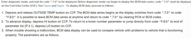

HMAC300
  • 48,601 POSTS
because you have automatic temperature control do what is listed in picture and get back to us with codes. it will be an F code.

SEAN030888
  • 36 POSTS
Hi I filled my 1992 cadillac Deville up with freon. It worked great for 2 days. Now the compressor won't come on. I get codes f46 f47 and f48. I did some research and these codes mean low refrigerant and f48 means refrigerant problem. What could be the problem. Thanks.
HMAC300
  • 48,601 POSTS
I f you had to fill it and didn't check for leaks nor fixed them it's more than likely out of Freon again.
