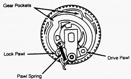

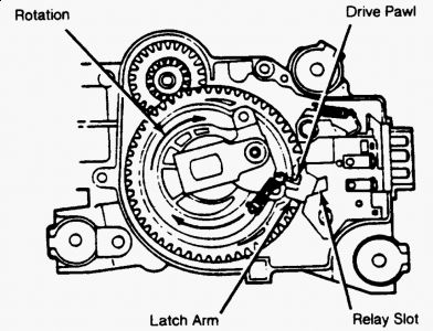

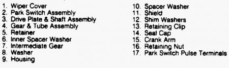

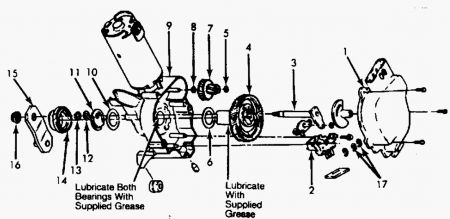

My caddy has a problem with the windsheild wipers that won't shut off properly. You can turn them off but can't shut them off the right way. I have discovered get off you have to turn the switch in the off position, shut the car off, then open the door and the wipers will shut off. Then when you turn the car on the wipers will drop to the home place. Is it the motor or in the switch and is it easy for me to repair at home as I have done the surpatine belt at home.

WIPER PARK SWITCH Removal & Installation Remove wiper motor cover. See WIPER MOTOR COVER . If wiper motor is in parked position, operate motor to remove lock pawl from relay slot. See Fig. 3 and Fig. 4 . Remove park switch. To install, reverse removal procedure.

WIPER MOTOR COVER Removal & Installation Remove wiper motor from vehicle (if necessary). See WIPER MOTOR R & I . Unplug electrical connectors. Remove wiper motor cover screws. Remove cover. To install, reverse removal procedure. Tighten screws to 18 INCH lbs. (2 N.m).
