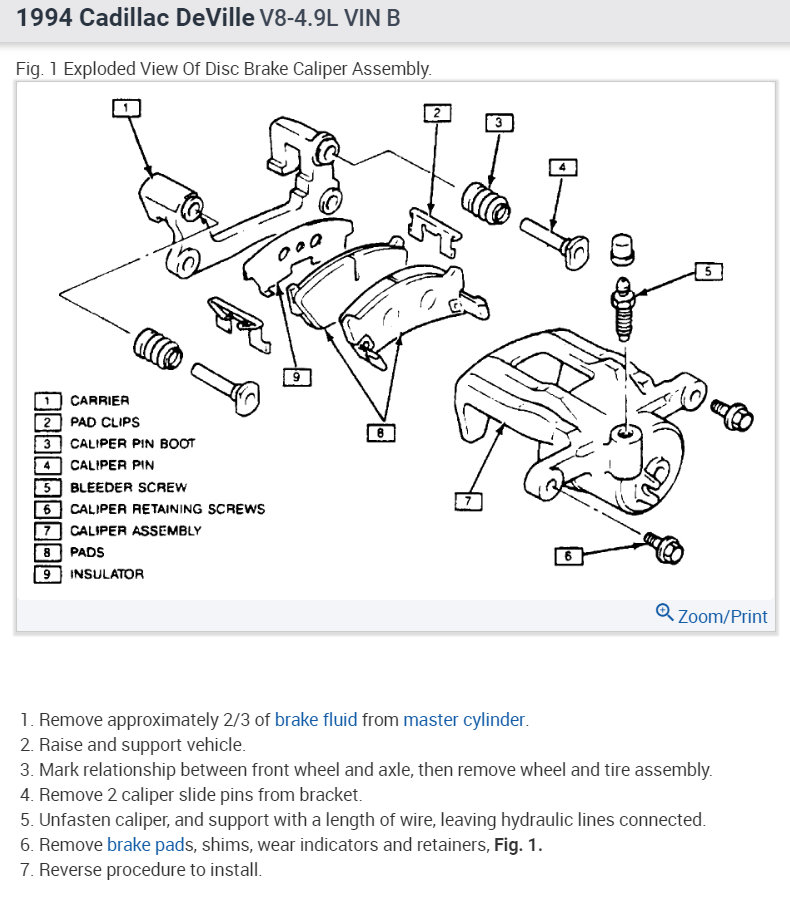

how in the heck do i take off the caliper to change brake pads??? how to remove slip cover bolt or whatever it is??? thanks

Here is a guide to show you how to replace the front brake pads and a diagrams to help you see what it will be like on your car.

I am trying to replace a couple wheel studs on my front right wheel an am not understanding how to get the calipers off so i can get to the studs. What is the easys way to replace the front wheel studs?

your calipers should have two torx bit bolts on the inside of the caliper. once you get those off , then you will remove the rotor and get a press or c clamp and press the studs out of the plate.

I am in the middle of trying to get the caliper off now. I do not have a Torque wrench so is there any other tool that i could use to get the torque bolts out with like an allen key or something. An if so what size are the bolts ?

its a 3/8th in hex nut or allen wrench, to get the studs out hit them with a hammer, to get them back in use two of you lug nuts to do it

What kind of tool besides a torque wrench would i use to remove the two torque bolts from m front calipers so I can get to my replacing my wheel studs? Alos what side bolts are in there because i can't find anything to fit them?

its a 3/8 in hex nut not a torx, and a wrachet
