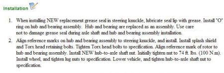

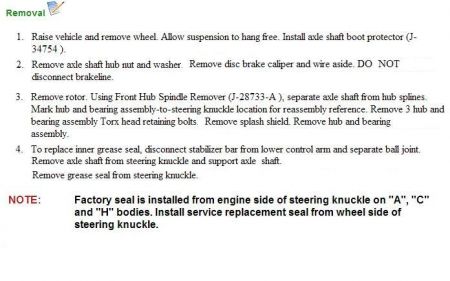

1993 Cadillac Deville front wheel bearing
MANNYCASS
MEMBER
1993 CADILLAC DEVILLE
What is the simplest way to install the new front hub?
Also what size socket is needed to remove the nut on the spindle?
Wednesday, December 30th, 2009 AT 5:10 PM
BLUELIGHTNIN6
MECHANIC
16,542 POSTS
SPONSORED LINKS
-2
Wednesday, December 30th, 2009 AT 5:17 PM
