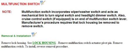

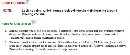

anyonye know how to disconnect the swich from under the dash so i can pull it out? diagrams anyone?

https://images.2carpros.com/forum/automotive_pictures/261618_Noname_1393.jpg
https://images.2carpros.com/forum/automotive_pictures/261618_Noname2_412.jpg
