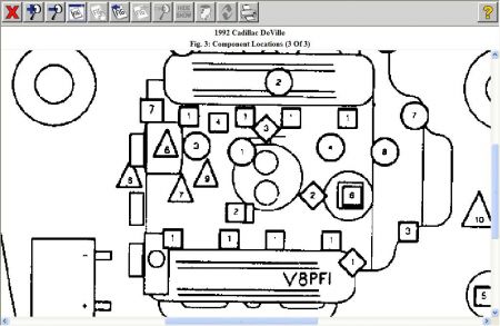

I just baught a little chip that is supposed to be installed to the IAT Sensor an am not positive if i found the right sensor. This Chip is suppose to help out with the boost gas mpg an some horsepower. From my knowledge the sensor i understood it to be was right by the air intake filter by a 5 inch cylinder that has about a 3-4 inch diamater that says air ontop of it! There is to 2 hoses coming out f a little black box on the cylinder too. Does this sound correct?

I've look for the intake air temperature sensor non was listed on the software am using-however it has a manifold air temperature sensor at item no.3 see below
https://images.2carpros.com/forum/automotive_pictures/12900_mat_sensor_1.jpg

the MAT sensor is the same thing as a IAT. its on the intake by the #2 injector
