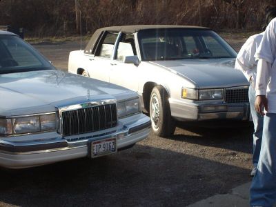

Hey Guys You Are highly reccomended for the DIY Guys in the world! However I have come across aproblem that has me miffed! My 1990 Deville tarted Leaking collant about a week ago, knowing the common Joe I tried the stop leak products to no avail! I changed the water pump because the root of the problem seemed to be in that general fool proof area. After completing that , the collant was leaking from the front of the car which i think signalled a leak from the hoses. After inspecting them I was still leaking. My Question is.. " Is there a freeeze plug in that area that could be causing me all this greif? I am low on finances and this is getting costly! Help me 2pros I will greatly appreciate it. Thank you kindly theruler...[img:f3b4a8081f]http://www.2carpros.com/forum/automotive_pictures/328698_Eastside_Kickit_4808_016_1.jpg[/img:f3b4a8081f]
