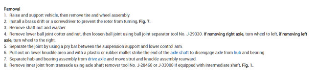

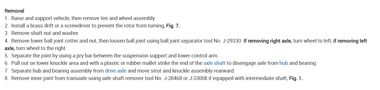

You have to pop the lower ball joint so that the strut and spindle can be pulled out to get the axle out of the hub

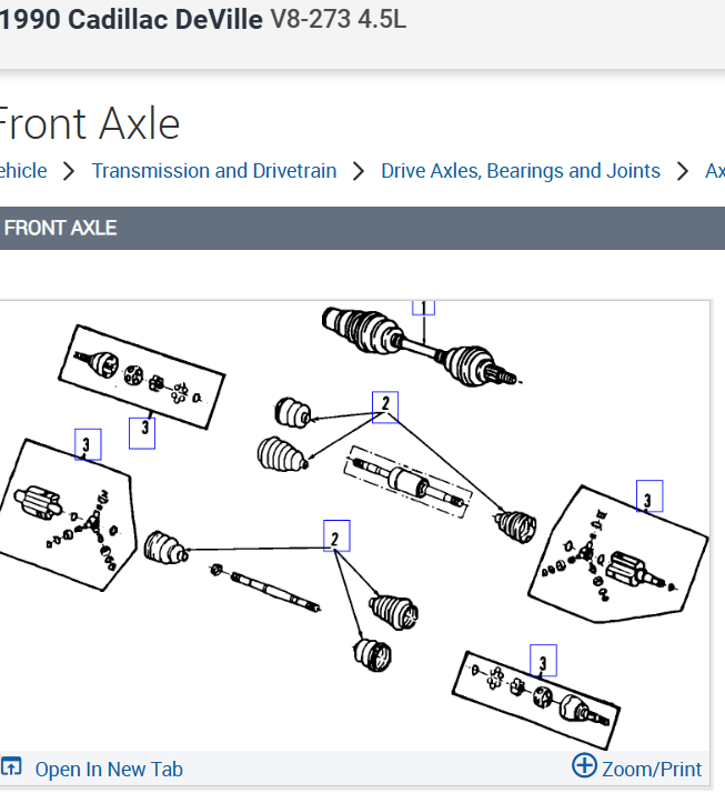

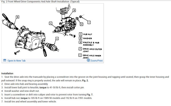

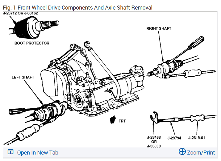

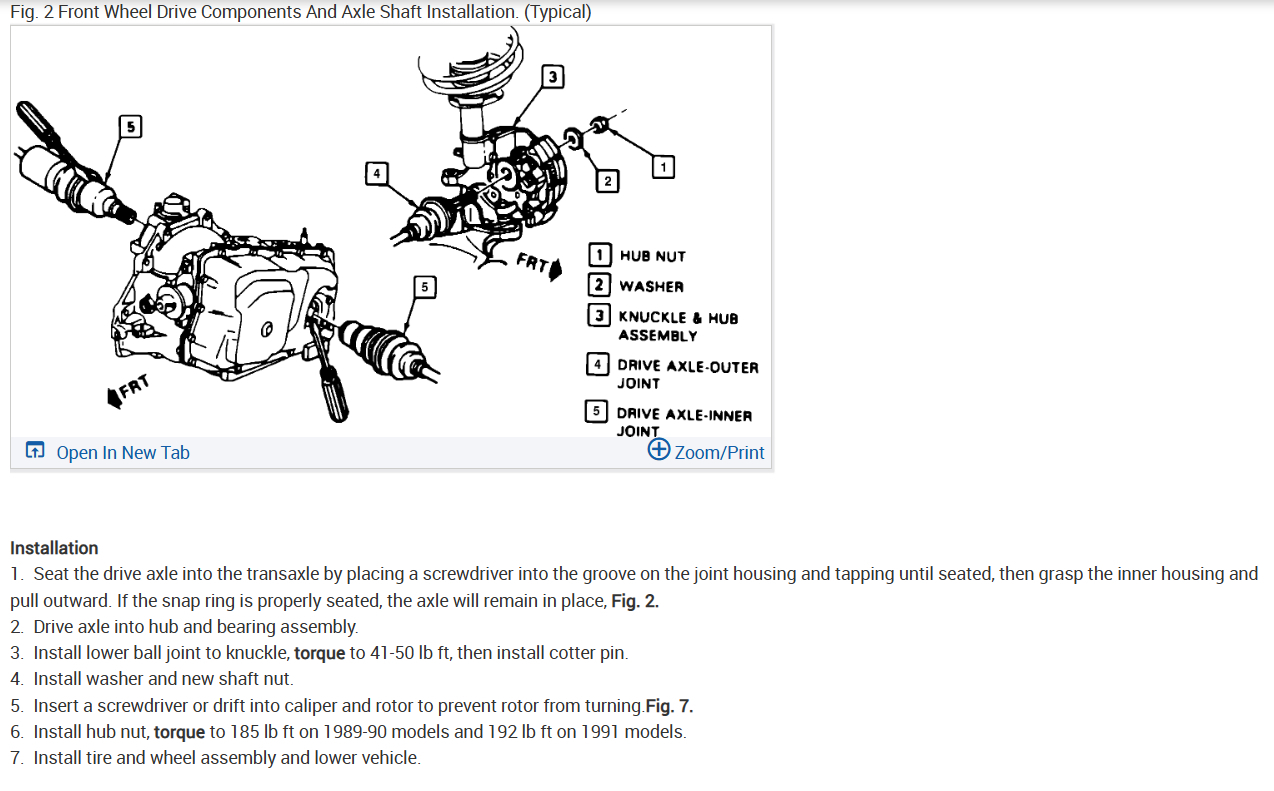

They make a special puller for this job if a large pry bar will not work, please check out the diagrams below for the instructions on how to remove the CV axles ands half shaft. Check out the images (below). Let us know how it goes
