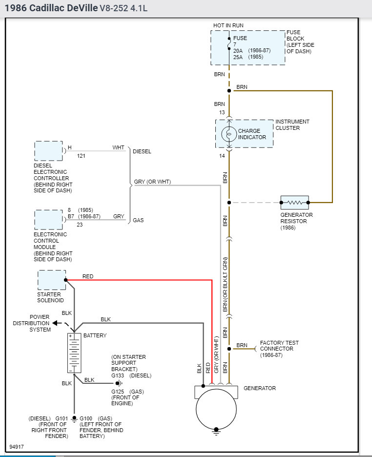

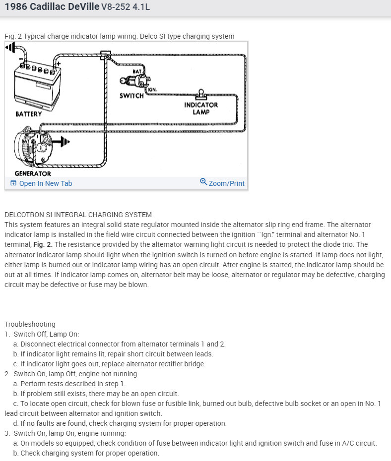

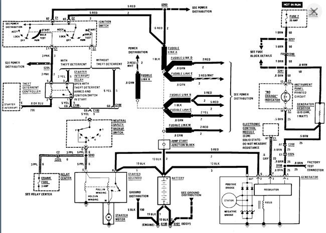

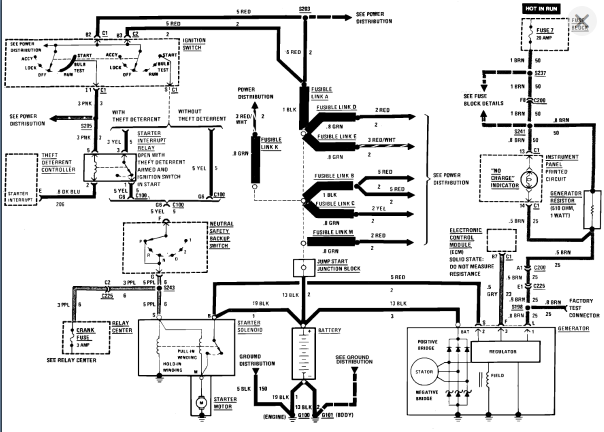

The charge battery light stays on after car has been started.
Jul 26, 2009 at 6:19 PM
SQM
  • 6,383 POSTS
This could be a wiring issue or a blown fuse.
Check the fuse number 7 in the fuse box that is located on the left side of the dash.
If the fuse is good, then it is likely a wiring issue.
I have attached the troubleshooting guide and the wiring schematics below.
