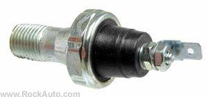

I can't find the oil pressure switch on my 368. Found a sensor on the back of the block, but had only one wire. From my understanding it should have at least 2 and the one from the parts store has 3. Can someone please help? I would really appreciate the help.
Oct 13, 2008 at 12:28 PM
  • 75,992 POSTS
It only has one male spade terminal on it

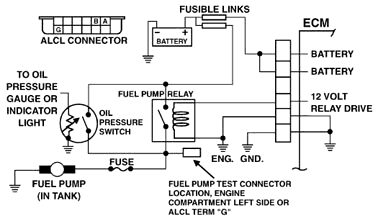

My understanding is that it has 2 circiuts. One for dash light and one 4 the fuel pump. It's supposed to be a back up 4 the fuel pump relay. Is that wrong?
Oct 14, 2008 at 11:23 AM
  • 75,992 POSTS
Not too familiar with your model-Yes there's such thing as fuel pump/oil pressure sending unit-see below how its wired into the system
https://images.2carpros.com/forum/automotive_pictures/12900_oil_sending_unit_and_fuel_pump_circuit_77.gif

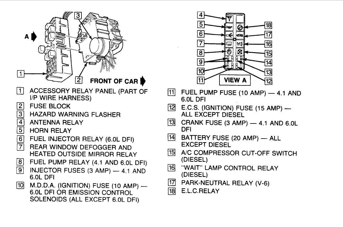

The parts store got me the right one. Thanks. Now how do I find which relay is the fuel pump relay?
Oct 15, 2008 at 1:53 PM
  • 55,433 POSTS
The fuel pump relay is located on relay panel under instrument panel to the left of the fuse box.
