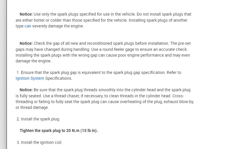

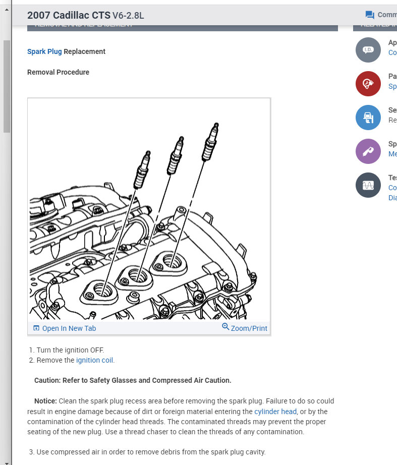

How do you change spark plugs on an '07 cadillac cts 2.8 engine?
Oct 27, 2010 at 4:15 AM

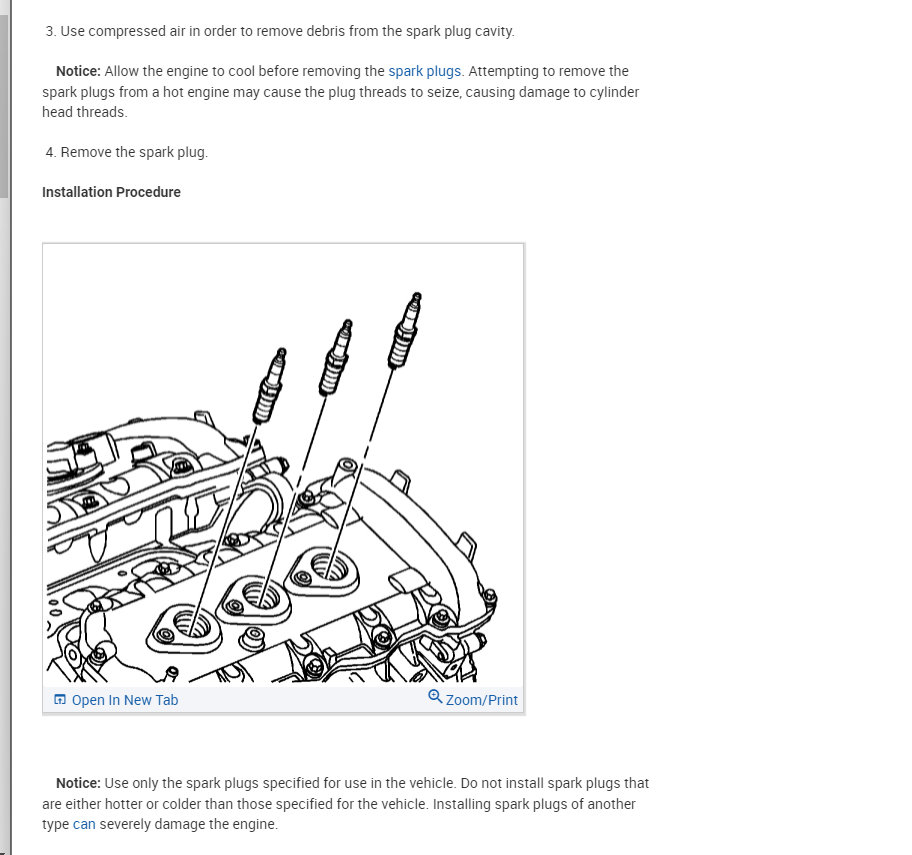

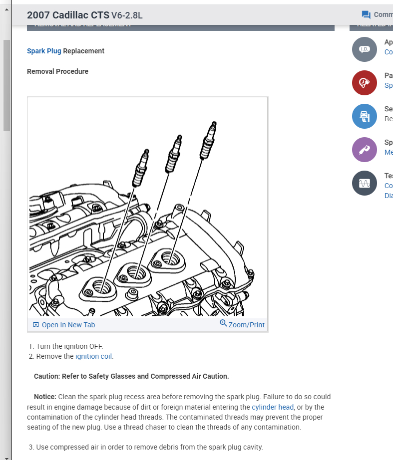

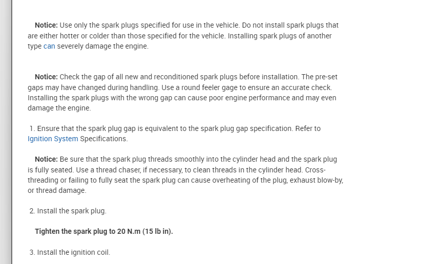

I am going to attach the entire process below on how to replace the plugs from the manual.
Here is a video that will help with gapping the plugs as you will need to check them.
https://youtu.be/c9_NVXiwvYg
Please see the info below that is attached from the manual for your review.
Please let me know if you have questions on this.
