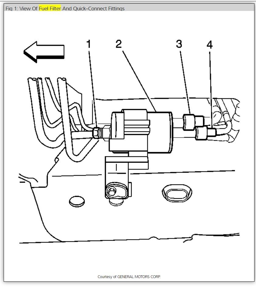

Where is the fuel filter located and what is the process to replace it?

It is located below the rear passenger door, just inside the frame (3.6L ). Here is a guide to help you

Relieve the fuel system pressure. Refer to Fuel Pressure Relief .
Fig 1: View Of Fuel Filter And Quick-Connect Fittings
Raise the vehicle. Refer to Lifting and Jacking the Vehicle .
Remove the rear suspension bracket. Refer to Rear Suspension Bracket Replacement .
Disconnect the quick-connect fittings (3 and 4) at the fuel filter inlet. Refer to Metal Collar Quick Connect
https://youtu.be/Boi0DPXVHbM this is for a ford but the process is the same
Fitting Service or Plastic Collar Quick Connect Fitting Service .
Disconnect the threaded fitting (1) at the fuel filter outlet.
Drain any remaining fuel into an approved gasoline container.
Remove the fuel filter (2).
Remove the fuel pipe O-ring.
Discard the fuel filter into an approved container.

How do you get the two small hoses to release from the filter?
Apr 1, 2019 at 5:42 AM (Merged)
FACTORYJACK
  • 4,159 POSTS
There is a special tool(s) that release the fuel line quick-connects. It can be either one tool with both line sizes, or two seperate tools
